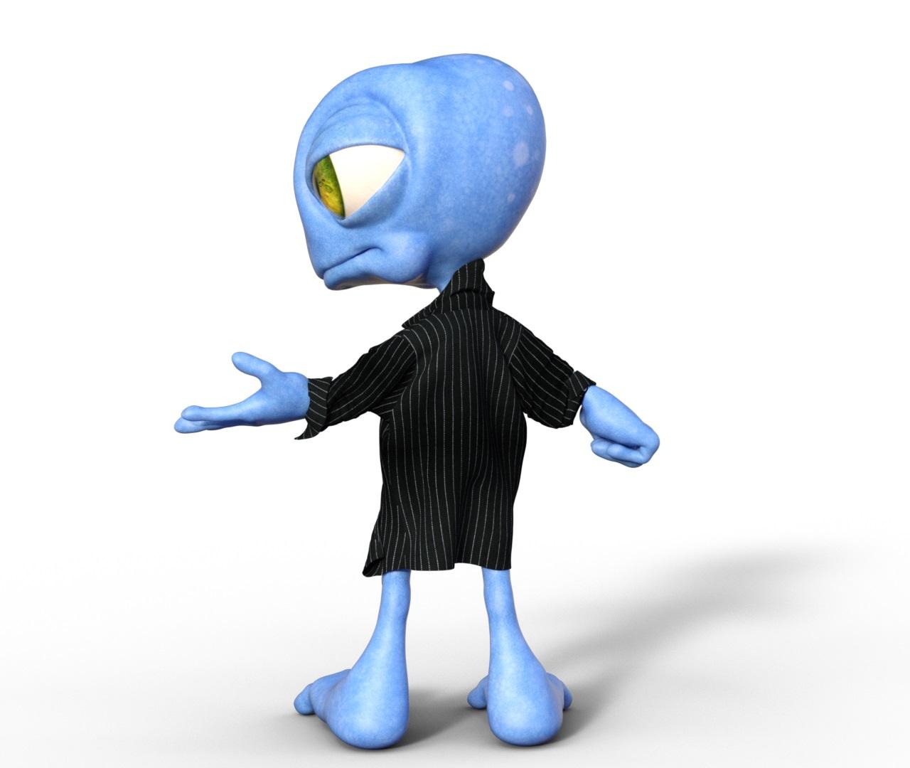

  • ArtiniArtini Posts: 10,591
    edited October 2017
    Great work, Daz 3D team. Now even clothes with "Self Collide" set to "On" work for me.
    Attitude shirt on Blue 2.0. Finally I can dress her/him properly.
    https://www.daz3d.com/blue-2-0
    https://www.daz3d.com/attitude-outfit-for-genesis-3-male-s
    1280 x 1080 - 262K
    1280 x 1080 - 141K
    Post edited by Artini on
