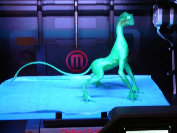

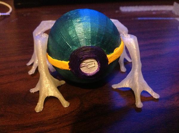

  • thoromyrthoromyr Posts: 452
    So, you send in your OBJs and have them print to 3d for you? That just sounds too fun. I've seen that those new freebie Autodesk Smartphone modelers offer a 3d print service.
    So what sort of things do you get back, like a little plastic model of your character, or what?
    I missed your post somehow until 3dage's reply. The printer sits on the desk next to my mac, loaded with PLA filament. Send it a print job (special software required) or load a print file from sd card (must be effectively 'printed to file' first). My hand isn't steady enough to do quality painting, but you can paint the result or take the native appearance. PLA tends to be slightly transparent which gives a nice effect. The green guy is printed with 0.15mm thick layers and was sized for maximum capacity of the printer (about 10" long IIRC).
