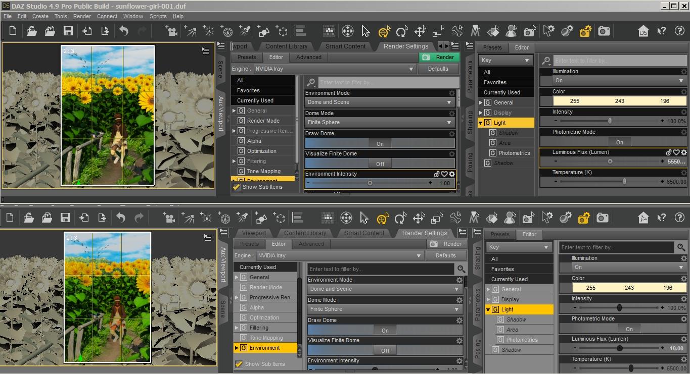

    Something I came across too is that changing from Studio 4.8 Pro to 4.9 Public Beta changes the light intensity. I did this scene in 4.8 and then loaded it into 4.9 and it was dark at the settings used. In 4.8 the Luminous Flux for the Key Light is 10, in 4.9 I had to turn it up to 55500 to get the same amount of light, at 10 it was too dark. There are another two lights set at 5 in 4.8 which I had to increase to 1500 before they would show any light. No other settings needed changing, I will need to change her skin though as she has got quite a tan in 4.9 :)
    Click on image for full size.
    1365 x 741 - 582K
    Post edited by Fishtales on
  • ToborTobor Posts: 2,300
    This appears to have been a change in the way the distant light is calculated. In 4.8, the light is calculated as lumens incident per centimeter square; in 4.9, they inexplicably changed it per meter square, several orders of magnitude difference. I don't use distant lights much, but when this change was first discovered some months ago, people reported that the apparent brightness was corrected by multiplying the old value by 10000 -- that's the difference between cm and m.
    Iray's default unit of measure is the meter, whereas it's the centimeter in D|S. I suspect that the change in distant light was unintentional; but if intentional, unwarranted. At least the light is still based on incident illumination (as the value of the sun would be) rather than radiant power measured at the source.
    There may be changes in some of the other light factors, too, but not to this degree. Other differences may have to do with changes slipstreamed into the Iray engine.
