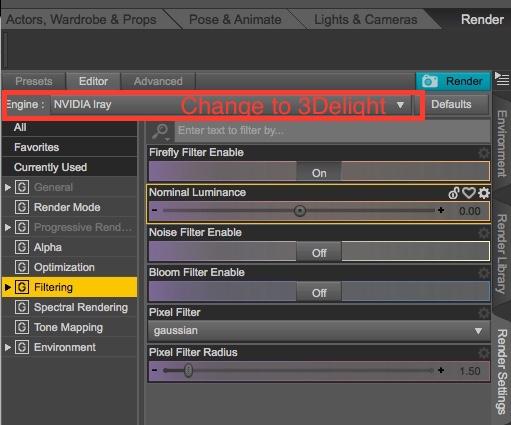

How do I turn off Iray and render in 3Delight?
  • nemesis10nemesis10 Posts: 3,845
    edited September 2017
    Change the render engine on the render tab under "editor"
