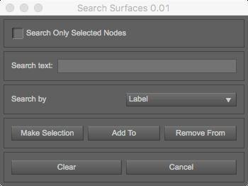

If you've ever worked with a complex scene with lots of nodes and surfaces, you know how difficult is is to select all the "Lights" for example in order to change their brightness or make them into Iray emissives. This script should help with that. It allows one to find and select by material name or by material tag in an intuitive manner. Just launch the script and see.
SearchSurfaces
Download it here, or clone it from Github here.
There's a README with some basic instructions, but if you have any questions, feel free to ask.
Thanks to @timmins.william for inspiring me to get this done and released.

    Here's an example of using it to convert Iray to 3dl.
    The steakhouse is Iray only... no problem! I'll just use Esemwy's Irayto3DL... bam. But... the glass looks terrible and nothing is glowing (obviously). I've done this conversion before, and it was a real pain, trying to find and select all the glassware and convert it to a glass shader.
    But now? The Search script nabbed them quickly. Bam. Then converting en masse is easy (which I did a few times until I got a glass shader I liked).
    Same deal with lightbulbs.
    Post edited by Oso3D on
  • Oso3DOso3D Posts: 15,120
    Going the OTHER way, converting an older 3dl-only product to Iray, I really wanted to add some translucence to all the greenery. That... would be tricky.
    But with the Search script, I could add Fern, Grass, GroundPlant to the list of selections. Then I removed 'Trunk', because FernTrunk had been added and I didn't want translucence there.
    With all the greenery selected, easy to adjust translucence and translucence color. Bam.

    so besides iray, this could also be used to change surfaces for pwToon quickly through a whole scene, right? (that's why i searched the forum/saw this here in the 1st place...)

    I tried to use it on my Mac (the script is installed in a subfolder in my "My Library" folder, located in "/Users/[Username]/Documents/DAZ 3D/Studio/My Library"), but the minute I click to launch the script from my content library, Daz will crash, weather I'm using Daz 4.21 or the latest Public Beta. And the crash happens too fast and nothing is writting in log.txt sad
    I have other scripts installed like this one and they are working fine.
    Any idea about what could be the cause of the problem ?

    I stopped using a Mac for DAZ years ago, but the script still seems to work on my PC under 4.22. That said, I can't think of any reason it wouldn't work on a  Mac. It does seem to have suffered from some loss of functionality over the years, or I've forgotten how to use it.
    Regardless, any other Mac users out there seeing something similar?
