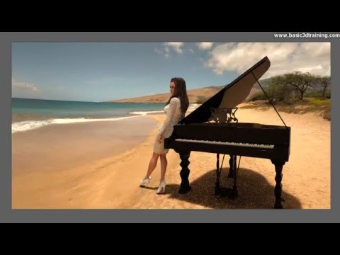

     this tutoriall  helped me lot,  to controll DOF more flexible.  (Before I really believe, composit is not 3d work,, but I changed my thinking,
    use composit or layer when we  need. it is same when we adjust tone mapping when render. )
    And I believe, DOF need to work both side where out of Focus.
     (forground and background become blur with dsitance from focus point) but only set focus and show clear, about area, which you set.
    then forground should be  blur. to change it we need to layer  work I think.if use DOF.
