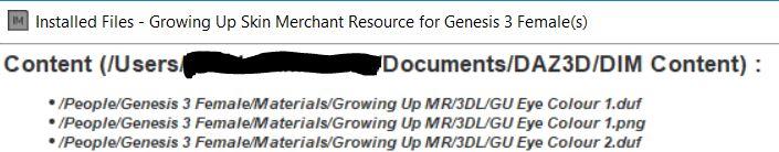

    Here's the problem as I see it - the install path for th eolder products is still pointing to the Mac folders.
    Mac PATH:
    Windows PATH:
    705 x 138 - 36K
    735 x 137 - 38K
    Post edited by marble on

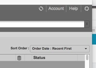

    When you click on the gear , and change  the installation location for Daz studio, it doesn't change?

    The installation locations are correct for Windows (which is what I'm using). It is the old location from the Mac files that is wrong.
    Sorry, I'm not making myself clear because I don't really know what is going on. DIM has records from before and after I moved files across from Mac to PC. The products installed before the move still have pointers to the Mac folder path. Those installed since the move are correct.
    So the problem is that if I uninstall and attempt to reinstall an older product - DIM just does nothing. It uninstalls it without a problem but will not re-install it no matter what I try.
