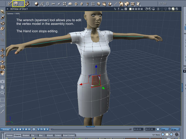

    1052 x 784 - 165K
    You can use the object file without having to rig it in Carrara, D/S, or Poser. What you would do is bring it into Carrara and go through the steps Andy outlined above to fit it to V4. In the Assembly room, select both the .obj you want for clothes, and the hip of your figure. Go to the animation menu and select Attach Skeleton. You will most likely have some collisions and poke through, but most of these may be able to be solved by weight painting the bone's influence on the clothing object. Those that prove troublesome can be adjusted by editing the mesh of the figure or object, or hiding troublesome body parts.

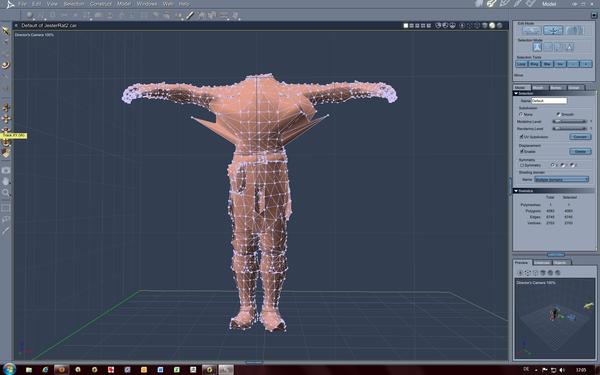

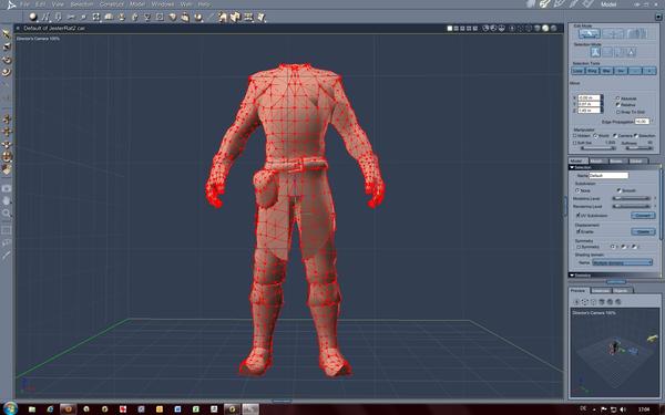

    Is there anywhere a good tutorial for weight painting clothes, so I can get started?
    Somehow I can't manipulate the mesh in "animation mode" within the Vertex room. I am quite sure that I saw some sort of tutorial looooong ago, someone using this to fix broken meshes and clipping. But can't find that video anymore :-/
    Somehow I can't get into the weight painting option and see the bones I want to edit and all that...
    1680 x 1050 - 530K
    1680 x 1050 - 552K
    In the first image, the only tool not grayed out is the brush tool. Try selecting that, then there should be a pull down menu on the right with a list of the bones, such as hip, etc.
