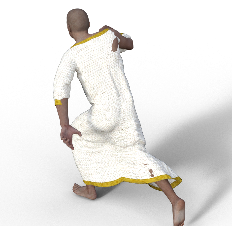

    Here it is on Michael 5. I parented it instead of fitted it to the chest. It bunches a bit around the neck, but doesn't look too bad. Let me try a pose and see what happens.

  • LlynaraLlynara Posts: 4,772
    edited May 2017
    Oh yeah, that's bad. I'll try mindsong's directions. We must've posted at the same time.

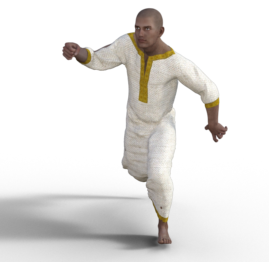

    I couldn't find the key icon thingie on the timeline (I'm exhausted), but I liked the idea of treating the clothing as a prop, so I did this:
    1. Load figure.
    2. Load tunic, but do NOT parent or fit it at all.
    3. Go to Content Library and pick a pose. Apply to M5.
    4. Now apply the pose to the tunic (I think it's the tunic and not the rig in this case- one will work, one won't.) NOTE: It won't match perfectly because the bones of the tunic are M4. A converted pose should though.
    5. Use bends and dials in the tunic rig to adjust the tunic to fit the body as closely as possible.
    6. Turn the drape iterations down to 10 or so. Too many crinkles it up real bad and he looks like he's wearing shrink wrap made out of burlap!
    7. Hit the drape button and pray.
    Here's what I have so far. Not great but not horrible. Gotta sleep, more tomorrow!
    935 x 910 - 619K
    935 x 910 - 818K
    Post edited by Llynara on
  • mindsongmindsong Posts: 1,781
    edited May 2017
    That's pretty good!, I like the outift when seen draped (yours looks better than the promos).

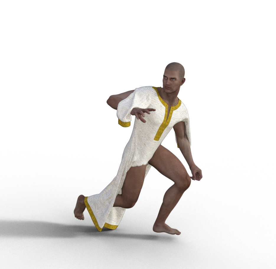

    The animation method is definitely the way to go when putting the dynamic clothing on other characters (and it's fun too!) Sleeves can be challenging, but most other clothing items do pretty well.
    Here's Dynamic Dancer for V4 on FW Chara for G3F and the Centaur Female.
    beautiful work! yes!
    (it's fun to watch it all fall into place in the animation process, don't you think?)

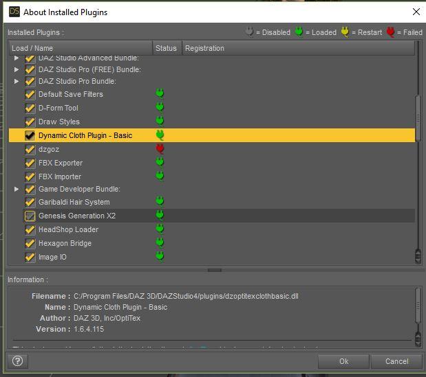

    So where did the $50 full Optitex Clothing control plugin go? The one I bought three months ago? Nowhere to be found. No place to add it or put in the serial number. Why sell something if it's going to be obsolete within a few months?
  • Oso3DOso3D Posts: 15,115
    edited June 2017
    What I usually do as a final step, once it's frozen or whatever, is add smoothing, collision, and usually a push modifier of about .1. That helps make the clothing look more substantial and helps fix a lot of minor pokethrough you may get.
    Llynara: I still see it? https://www.daz3d.com/dynamic-clothing-control
    Post edited by Oso3D on
    edited June 2017
    It's in the store, but not in the program. At all. All of my other plugins seem to be there. I will try downloading it from Product Library and reinstalling. Let's see if anything breaks.
