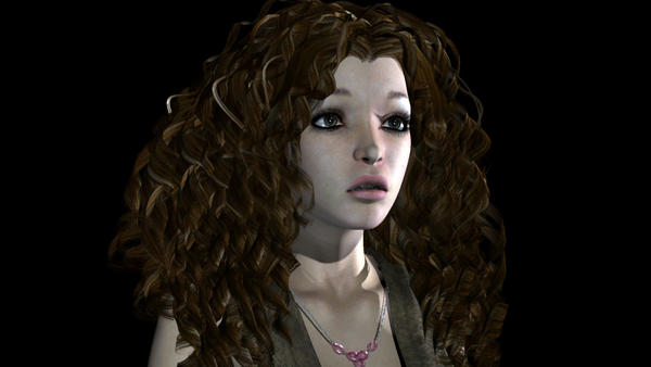

    In the figure above, the skin uses a specular map multiplied by a 1-100% slider, which I have set at 6%.
    Shininess at 4%
    Eyes are another matter. I have spent a lot of time working on the eye shaders and a special light rig that stays with them. Very subtle light that just helps them look glossy all the time, but from the direction of surrounding environment rather than a specific place on the eye. Took a lot of messing around and just thinking when I should have been sleeping, lol!
    But I should also mention that it all started from that kit I linked to above - but I rarely use the subsurface scattering. As a matter of fact, I went in and lowered the resolution of all of the texture maps to a quarter of their original size. (from 4000 x 4000 to 1000 x 1000) and for distance shots I'll even drop those to 500 x 500 if I remember to - which I usually do. In Carrara, it's not all about the maps - although good maps are the key. It's the power of the shaders that makes Carrara shine! Between that shader room and the awesome assortment of lights and their available settings and effects. Wow... look at the time...

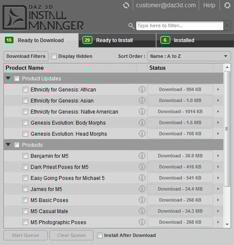

    Wow. This new Daz Install Manager is totally cool! It (if you don't tell it to delete them) puts your zips (instead of exe.) in a folder - so for questions like that, all I had to do is go to that folder, find the product and open up the zip and look at the structure. I'm on a laptop that had nothing Daz on it - no software... nothing. By the time I got done telling it what I wanted - which was over 470 products from 2007 until now, it had more than 30 of them installed already. As I wrote stuff down it just happily finished everything all by itself! :)
    Now, if I don't want to look in that folder, I can just open the manager, find the product - I can even conduct a filtered search in it, if I want, and I have the options to check the ReadMe, Uninstall, and it tells me whether metadata was installed or not - so I'll know if I should expect to see it in Smart Content.
    Want to know more? Read my whole experience as I went from knowing nothing about the thing - aside from the fact that it exists, to viewing the info page, through to the installation of my entire Daz Product collection from the store. No more hitting "reset" for me - except for software and plugins.
    Sorry... I get carried away at the keyboard, huh... :smirk:

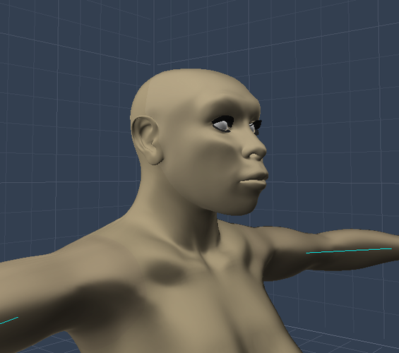

    With a little experimentation, I did get the V4 H. Erectus to load the morphs from within Carrara. When Carrara pops up the dialogue looking for Homo, search for the file I have highlighted in the screen shot.
    Carrara wouldn't even ask me to locate a file for the M4 version and I couldn't figure out how to manually load the file.
    FWIW I'm using Carrara 7.2 Pro.
    The shaders will have to be extensively tweaked.
