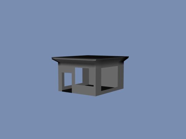

OK THis is BS, I have been trying ALL night to do this. In Hexagon I have created a simple little building. With a ceiling, a foundation, a glass door and window, a sign post, and the parking lots and driveway. I have TRIED to send it Daz as a whole setup, and when I do it goes as a solid figure with the concrete texture ALL over it. WHY? I tried to save each part separate as an obj but the WHOLE scene goes with it, ans the material files get re-numbered as they go.. THe building itself where I cut out faces for the door and the window, they come back closed in. WHY?

1. DS doesn't handle Booleans very well, so if you made you cuts with Boolean operations, that may be part of the problem. You need to make sure the cuts are 'real' and are not procedural.
2, Some apps (most actually), when exporting an obj will export everything visible as the obj. In DS, when exporting an obj, you turn everything you don't want invisible by using the 'eye' icon. In Blender, there is a 'selected only' check box...look for something similar in Hex.

So, watching tutorials I wanted to see if I could do it from scratch. Using the texalate tool, I made the cuts for a window and a door. I even made the frames to re-insert back into the openings (as Gary showed), and applied a glass texture. Those faces for openings, I didn't use the boolean, because of what he said about that, so on the first try I simply deleted the face(s). When I sent that back to Daz, the faces closed back up. So on a second try, I extracted those faces then deleted. Still didn't work. If I remember right, when Gary extracted the face he never did delete them, just pushed them out of the way and hid them. The door I extracted and put back in Daz was way over by itself. Trying to send my created building, I did hide every other piece except what I was sending, but the whole thing went together everytime. And when trying to send the whole thing it all becomes the concrete texture, numbering to 10 digits.

You know, that's why I did say a long time a go I liked Blender much better. I was on it probbly almost two years before I discovered Daz and Hexagon. I may go back to Blender, now that I understand better about saving as a dae file that opens in Daz in scale everytime. I am trying something else out in Hex. With each step as I progress, I created a cube with the front face CUT this time, sent it to Daz, okay it worked. Then I did a texilate cut at a point, extracted the partial edge to the other side. Created a point there, then welded the two together, and bridged the edges, that worked okay in Daz. So I guess I am going to see if I can re-build the front face to the way I wanted it in the first place, then apply the texture and see what happens, when I send that to Daz..

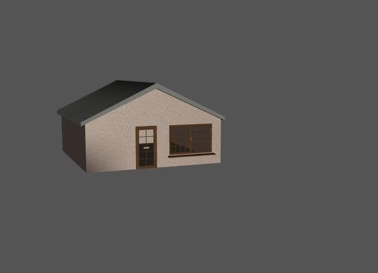

now this is a little quickie doe in Blender, however bringing it into Daz then Hexagon, Daz will not keep the textures applied in Hex. I mean I like Hexagon, as I am gettung used to it. but there's some things about it that makes me crazy.
I think I got it now, sorta. IN Hexagon I created the simple building. As I learned from the Miller tutorials, I disassociated the roof from the lower part. And then deleted the roof and saved the buidling as an object, then vice versa;deleted the building then exported the roof as an obj. Brought them both back into Daz, applied the textures then added the door and window from Room Creator2. Yeah, it looks amateurish but I did figure this much out.

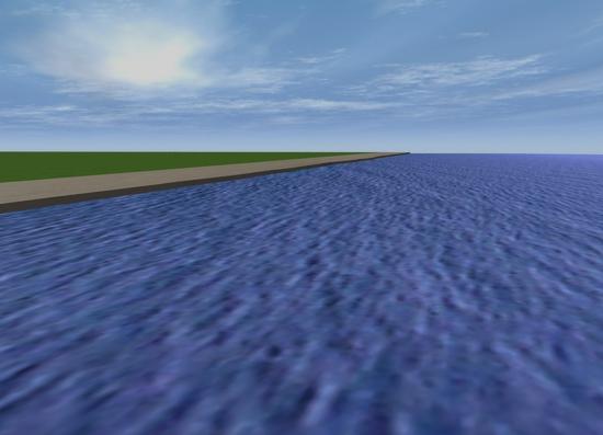

and before the building...IN Hexagon, I created the shoreline, sent that to Daz (turning off the smooth in the Surface tab) and saved it as a prop. Then brought in the duplicate and pushed them together so they become one. Then in Daz created the 'lake' from a simple cube flattened down a bit. The grass is the Skydome, I just changed the ground texture to grass. I've got them all lined up together, except for the lake it's lowered down a bit for the sake of the shoreline. In Hexagon, the shoreline has several indentions (I divided and divided again, just moving the verices in or out a bit, and lowered the faces for the drop in the surface) and as I lengthened out the side they smoothed out a bit better, then in Daz with the smoother off, they took on a more natural look.
