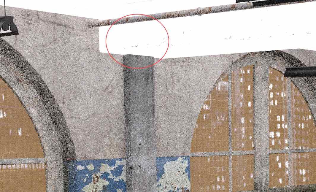

So I want to light a scene even further, and so turn the entire ceiling of a room into an emission source. This produces exactly the lighting I want save for one thing: the ceiling itself now looks like an incandescent bulb (red circle in the attached photo). I've tried adding the original ceiling jpg to the Emission Color, but that does not help.

  • Setting the emissions value too high causes wash-out.  A good work-around would be to put an emissive plane just below the ceiling to provide the actual light, and give the ceiling itself a very low emissions output so that it just glows.  And, of course, set 'render emitter' to 'no' for that emissive plane.

    It may or may not help, but instead of just choosing an emissive color, I plug the diffuse bitmap into the emission channel. That way each pixel glows in the color it was designed to have, rather than just glowing white.
  • fastbike1fastbike1 Posts: 4,082
    You did get an answer. Your emissive settings are too high. You can either reduce them or try the Ghost Lights products.
