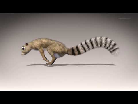

It worked in my experiments with  "Rodents by AM: Squirrels of Eastern Hemisphere" and "White Tiger for DAZ Big Cat 2"
