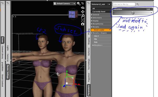

  • kitakoredazkitakoredaz Posts: 3,526
    about V4, we can not save the morph as dsf morph file. (only triax weight map figure, can save morph as dsf,,)
    and can not save the morph which you loaded as morph inject poze file in ds 4. I think.
    (there seems to be free utility made by forum member,,, I do not clearly know,,, )
    so you may need to use morph loader pro to load the morph shape as obj file which you saved ,,
    when you want to mix the shape to V4 on other scene.
    I recommend you update the daz 4.0.3 to 4.5.1.6 curernt newest suitable version,,
    because it can simply save the V4 with the morph as scene subset.
    it can keep the morph controller which loaded to ds and keep current value .
    and if you hope to mix the shape you can inject other character morph file to the subset victoria 4(which keep your original morph).
    in my pic,, left victoria 4.2 is loaded by usuall cr2 and morphs by power loader.
    so she does not have controller of my mixing original morph. (because I can not save the morph as new inj file,,)
    so I may need to load the morph obj file by morph loader,,,to use my original morph,,
    but right victoria 4.2_sub is scene subset which I saved before. she has every injected morph for V4.2,
    and she have my mixing morph in morph>morph loader section.
    of course I can inject new morph (if I get new morph,,) or remove some morph from her (which have rem file,,)
    so I can mix new shape too .
    1035 x 636 - 89K

  • HI TRY to convert v4 to weight mapperd  first  convert from M4 or V4, you need M4 or V4 in scene . There is a ... In Scene Tab, go to edit—rigging—convert figure to weight mapping.  save like a new character the you can edit an save changes  in zbrush.
