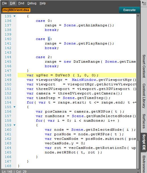

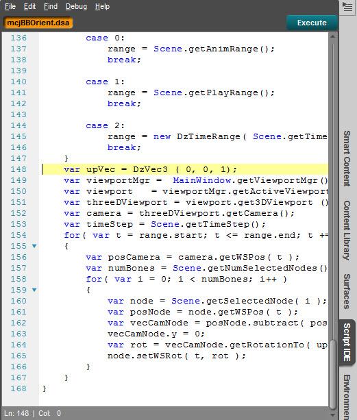

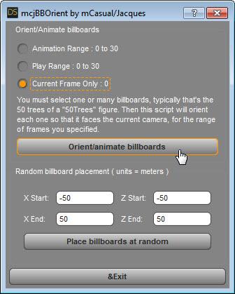

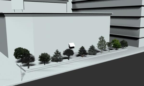

1. Download the mcjBBOrient script from here. Go to the bottom of the page and on the far right you'll see a down arrow - that is the download link. After downloading the file, install the script in the My DAZ 3D Library/Runtime/Scripts folder. The zip also contains a figure having 50 billboard trees; you do not need to install this for River Front unless you want it for other purposes.
2. Load a scene with a City or Low-Poly block(s). Expand the scene tab hierarchy so you can find all the tree props easily.
3. Open the script. I do this by going to the main menu and choosing Window/Panes/Script IDE which will put another pane in your workspace (I have this opened and docked all the time as it makes it easy to get to a script). Click on the Script IDE menu File/Open Script, open the mCasual folder, then select the script mcjBBOrient.dsa. Note the extension, the one with .dsa is for Daz 3 and 4, the other two scripts are for older Daz versions.
4. For some reason, the script orients the trees sideways to the camera, which makes them invisible (see 1st image below, you see the shadows but not the trees!) . I do not know if this is caused by a difference between DS3 and DS4 or if it has something to do with the trees in the City/Low-Poly products. I tracked down the problem and it is easy to correct. In the Script IDE pane, scroll down to line 148. Change the original DzVec3 ( 0, 0, 1) to DzVec3 ( 1, 0, 0). That's it. Now the tree will be oriented perpendicular to the camera.
Original Values: Modified Values:
5. To apply the script, go to the scene tab and select all the plant props. Go back to the Script IDE pane and click on the Execute button on the upper right. Click on "Current Frame Only" radio button then click on "Orient/Animate Billboards". The plants will now face the camera. Note that if you move the camera, the trees will no longer be oriented, so remember to run the script just before you render.
6. You can save the modified script by selecting from the Script IDE menu File/Save Script As and give it a new name (I chose mcjBBOrient RF.dsa).
7. Now that the script is modified, you can also access it from the Content Library under DAZ Studio Formats/My DAZ 3D Library/Scripts/mCasual. If you want quick access to the script, you can right click on the icon and select "Create Custom Action". The script will be added as a choice on the Daz Studio main menu under Scripts.

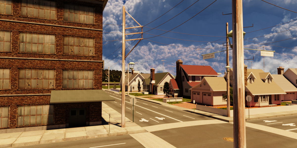

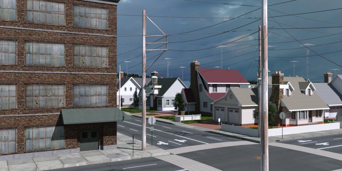

Here's a few more renders using Iray instead of 3DL.
6. This image uses a sky from Skies of iRadiance - High Sky HDRI Bundle for Iray This product comes with a lot of daytime, sunset, and night skies to choose from. As with any Iray render, you'll have to experiment with tone mapping and environmental settings to achieve the lighting you want.
7. This image uses a sky from Iray Worlds SkyDome which, unlike some Iray products, actually adds a skydome to the scene. It doesn't have to be this dark, I just did it this way since it was a sunset sky. There are quite a few different skies in the set.
8. This next image uses a sky from TerraDome 3 Iray. It has more skies you can choose as well as atmospheric effects.
9. The third image uses the default HDRI that comes with Daz Studio and a blue color added as a backdrop. The advantage of this is that no other product is needed but your skies will not have clouds nor fade near the horizon.
10. This final image shows the skydome that comes with River Front converted into an Iray emitter. To do this, you need to apply the Iray Uber Base to the skydome, go to emissions and add the sky image into the Emmission Color and Luminance channels. Set Emission Color to 1-1-1 and set Luminance to 300. I find the blue color in the sky is too intense and the sky a bit grainy. There may be ways to adjust for these but I don't have that knowledge.
There's lots of choices depending upon what you own. The same is true for 3DL, there's many skydomes that can be used instead of the one that comes with River Front.

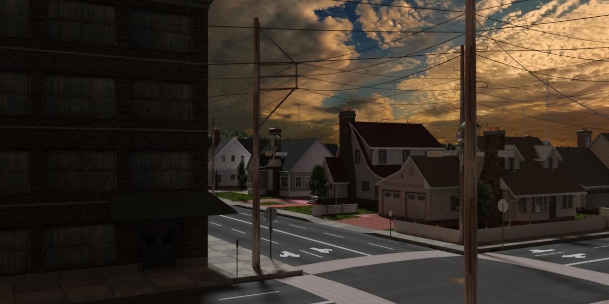

I decided to see what it would take to make a night scene. Here are the steps I followed:
1. In Render Settings, set Environment Mode to scene only.
2. Add a black backdrop to add in a black sky. Or if you want, leave if off, save the render as a png to preserve transparency, then add a night sky with stars in post work (see step 6 below).
3. I added a small sphere primitive inside the light on the power pole in the scene middle. Apply the Iray Uber Base, then set emission color to 1 and luminance to 5 kcd/m^2. That will make it appear there's a small glowing bulb in the lantern.

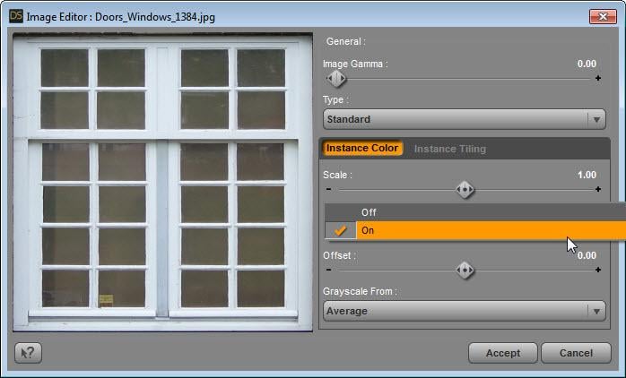

4. The windows in the Dreamland sets are images on top of the wall images. If you make the windows transparent, you'll see through to the brick wall. Because of this approach, you can't light the windows from inside the buildings. I tried making the windows on the commercial building at left emitters but didn't like how they looked (the grayish streaked windows just got brighter and looked unnatural) so I left them alone. To make the lights on the house at the far right lit, I selected the window surface, applied the Iray Uber Base, set emission color to 1, and set luminance to 1500 cd/m^2 (note this is cd, not kcd). Go to the Surface tab Base Color parameter and hover the mouse over the image on the left of the parameter bar. Identify which window texture is being used. Next go to the Luminance parameter, click on the small square on the left of the parameter bar and select the same window image as in base color. The dialog will close, so click on the image again, and without selecting any other image, choose the Image Editor from near the top of the selection screen. Click on the Invert button and turn it On. Click on Accept button to apply the inversion. You need to add the image so you don't lose the vertical and horizontal wood strips that separate the window panes. And you need to invert the image otherwise the window frames will glow, not the window glass.
5. I added two Ghost lights. A small one (50% scale) of 400K facing downward just underneath the lantern on the power pole. Then a large one (800% scale) with a 50K setting positioned on the grass lot in front. This is the main light that casts a soft ambient light across all the buildings.
This first image shows the effect from the light bulb, the lit windows, and the small ghost light.
This second image shows the final version with the large ghost light:
The render was quite rapid, just over 3 minutes for a 1200x600 image.

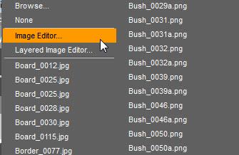

Apply the Emissive shader preset, rather than using the base shader preset and then turning emission on, to avoid having unneeded settings on and potentially adding to render time.

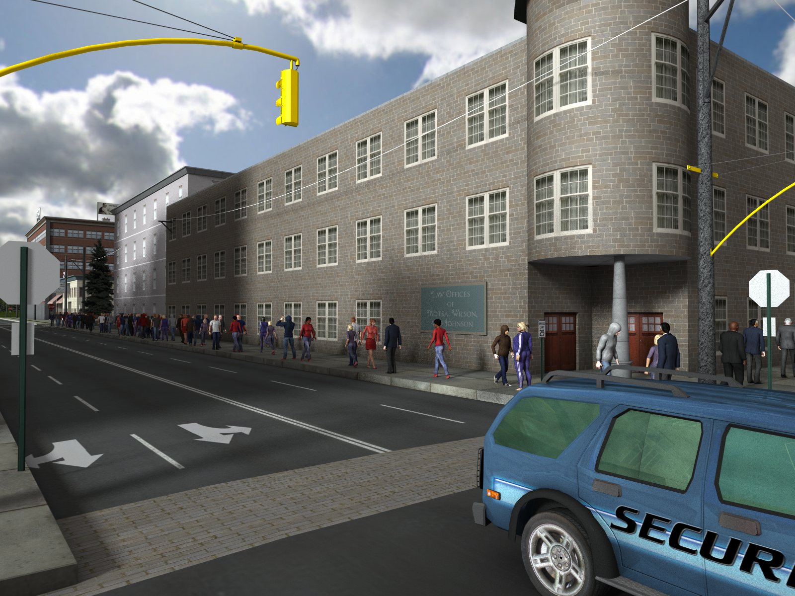

I've been wanting to do a River Front scene with a large crowd on the sidewalk. This is one with 85 figures, all based on Loretta Lorez and Lorenzo Lorez. I started with 17 individual figures, then used Ultrascatter to add 4 copies of each along the sidewalk. Here's the results (click on the image for a 1600x1200 render if you want to see the figures in greater detail). The lorez figures are not good for closeup but work fine when they are small or further back in the scene.

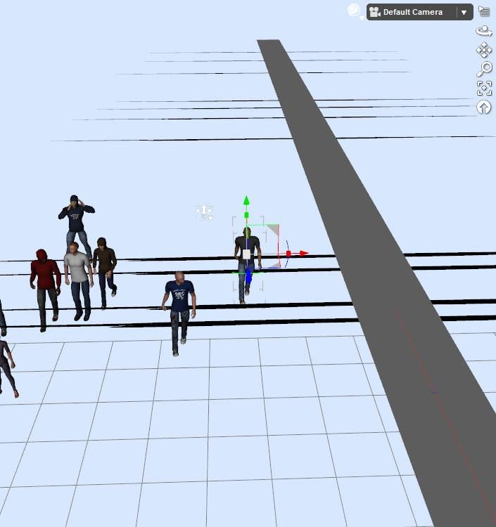

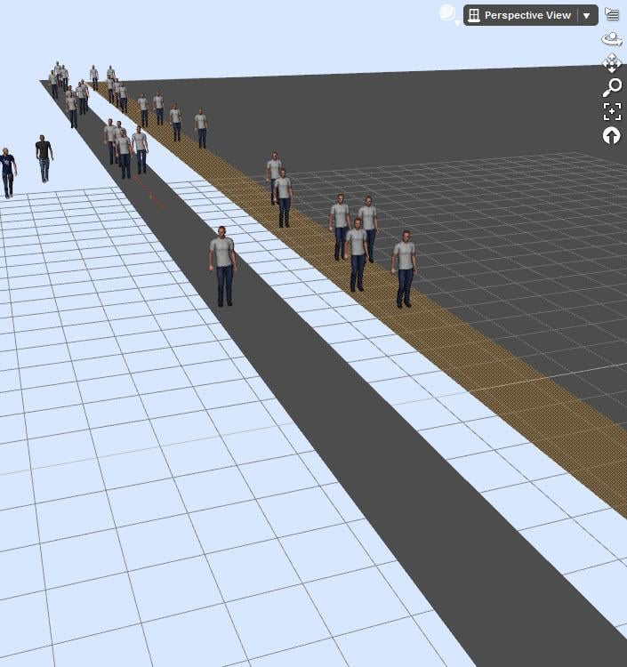

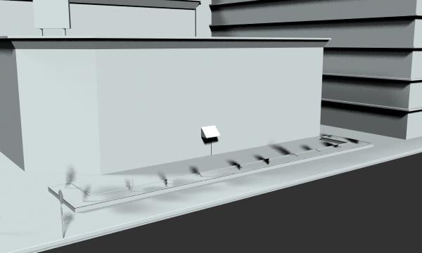

Adding the figures using Ultrascatter took a bit of work to figure out so I'll share what I did here.
1. My first attempt was to scatter the figures on a cube that was sized to fit a sidewalk in River Front (scaling of 2866% X, 57% Z, 0.1% Y). That didn't work well at all. Even with the box for "Inherit object scale" unchecked, the instances were terribly distorted to the point they just looked like horizontal streaks on the ground (in other words, they were inheriting the extreme scaling whether the box was checked or unchecked). You could break up the instance group, highlight all the instances, unparent them from the cube, and change their scale back to 100% for all 4 scale parameters and they would return to normal size, but that is way too much work.
2. My second approach used a plane. It's best to do this from a clean scene without River Front loaded since you're going to end up with a lot of objects to manipulate. From the menu, select Create/New Primitive and chose Plane as the type, 288 feet as the size, and 48 divisions (the ratio of length to width of the Riverfront sidewalks is 48:1). Next select the plane in the Scene tab, choose Geometry Editor in the Tool Settings tab, right click on the plane, choose Selection Type as polygon and Selection Mode as marquee. Drag the mouse to choose one row of polygons on any edge of the plane. This is best done using the top view and zoomed out enough to see all of the plane. Once you have that row selected, right click on it and choose Geometry Assignment then Create Surface from Selected and give it the name Sidewalk.
3. To scatter the figures, select one of them then run the Ultrascatter script. On the first tab (Distribution) choose the plane as the Target Object, set the number of instances to 4, set Max Slope to 5, and Min Elevation to 0 (you may not need to worry about this last one). On the 4th tab (Advanced), choose the Sidewalk for Limit Scatter To option and I chose Object for Preview Instances. Do this for each figure you are duplicating (I had 17 so 17 times).
4. All the figures face the same direction, so some need to be rotated. You'll also find that some figures overlap or may be floating or sunk into the sidewalk.To access the individual instances, you need to break them apart. To do this, use the DS menu and select Edit/Object/Instances/Break Instance Group. Do this for all instance groups. Now you can access them and manipulate the figures as needed.
5. Parent all the original figures and instance groups to the plane. Save it all as a Scene Subset. Merge it into your River Front Scene. You can position the group of figures by selecting the plane and using the translate and rotate parameters to put them in the desired spot. Hide the plane and you are ready to render.

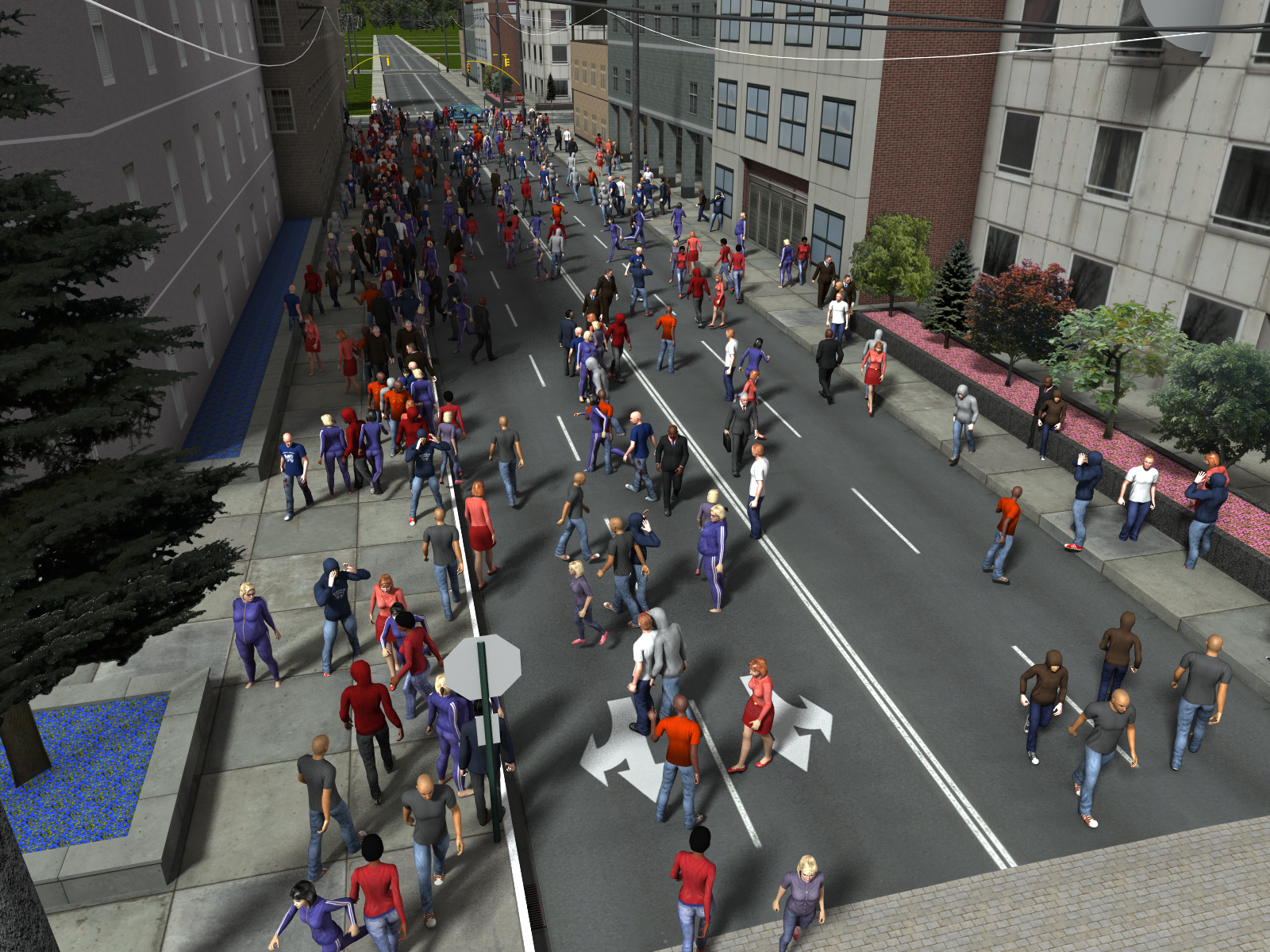

I decided to see how many people it would take to fill a block if it was set up like a street festival. This uses the same figures as before but more copies and spreads them out over a larger area. Since this was just a test, I didn't break apart the groups, so some people on the sidewalk are sunk into the ground or into surrounding planters. There a total of 362 figures in this scene. The Lorenzo and Loretta Lorez products seem to work pretty well for this and have not overtaxed my system yet, The 3DL render took 3 min 41 sec for a 1600 x1200 render. Since I'm only using 17 different figures, there's a lot of duplicates of the same person, but I plan to make a bunch more individual characters.The Predatron products have quite a few morphs and clothing options so that will help build variety. Click on the image for a larger view.

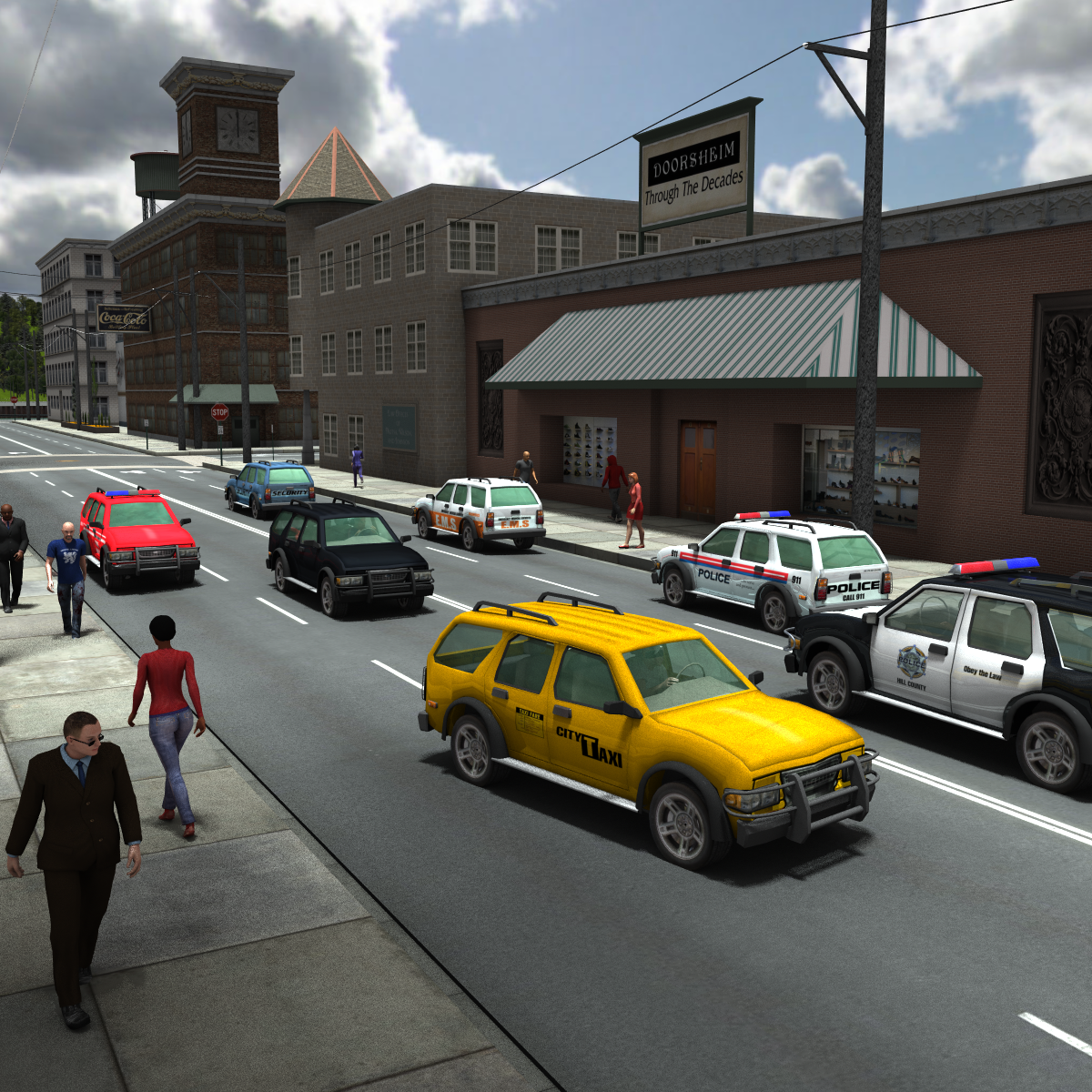

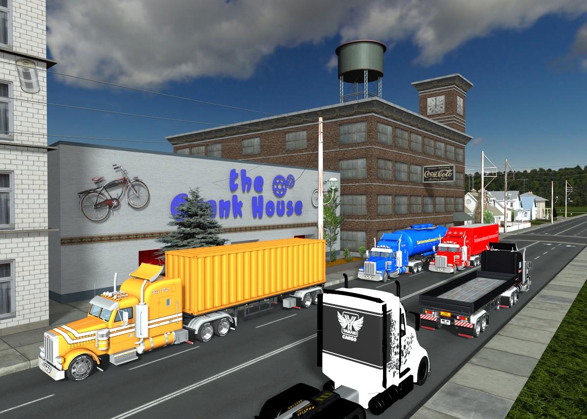

Cities have lots of vehicles: different types, different ages, different colors, different state of repairs. As I went through my content library, I was struck both by the small number of suitable (realistic) vehicles I have plus the lack of diversity. Looking in the store and searching online shows more but still nothing like reality. Another problem is that many of the car models that are available focus on the exotic: sports cars, fancy cars, fantasy cars, etc. I'm going to start showcasing some of the products I have and free models I can find, concentrating on everyday vehicles. There's this thread in the forums that lists free models plus this one. I also found this site where I've downloaded a few examples.
This render shows trucks from Big Bill Truck and Big Bill Trailer. You can mix and match four colors and four trailer types. I also show the cab and trailer from Yamaki Cargo. For all of these, you can also use shaders to change colors or add grunge. Since the city scenes are resource intensive, the approach I'm taking is to assemble a Scene Subset with the vehicles adjusted to the right scale and with desired texture modifications made. Then I can merge the ones I want to use into the city scene.
This is a scene with several of 1stBastion's Oncoming Traffic: Lo-Poly SUV's on the street. I show 7 of the 8 models. Most are some type of special purpose vehicle (fire, police, taxi, etc.) which is helpful for a city scene. You can of course change them up by adding your own clean or dirty shaders like Real Paint for DAZ Studio.They come with 3DL (used here) and Iray textures. Several of the closer cars have drivers I added - I had to decrease the opacity of the windows for them to appear.
As I did for the tractor-trailers, I laid out the cars, drivers and people in a fresh scene without the cityscape. I then merged in one of my city scenes and adjusted the position and orientation as needed. Much faster to do it without the overhead of the buildings and landscape,

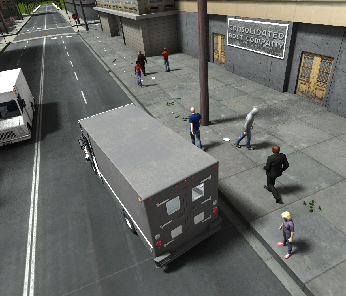

Few cities are pristine, so River Front could use some dirt. Other city sets can be the same way even if they come with grungy textures, as the streets may not have any debris in them. This example over does it but illustrates the effect.
1. Debris props were from Rubble in the Bronx: Alleyway (bottle, crushed beer can), The Garbage Pile (broken bottle, paper ball, paper), and Hilly Surround (morphing terrain with gray shader as paper). I had fewer suitable props than I would have hoped but you can find more by searching online.
2. I scattered 10 copies of each prop along a sidewalk using Ultrascatter. I found 20 copies of each way too many, so I went to 10 but 5 may be even better. Since you can't control where the script randomly puts things, you can break the instance groups apart and hide/move individual instances as needed. If you try this on a narrow plane matched to the sidewalk, you'll get flattened props so follow steps 2 & 3 from this post (where I create a sidewalk surface zone on a square plane). The props should end up laying right on the surface of the plane but you may need to adjust instance groups slightly up or down. I also found the paper ball too round, so flatten it slightly by adjusting the Y-scale.
3. Parent the initial props to the plane, which will have the Ultrascatter instances attached to it. That way you can position everything by just moving the plane. Save it all as a Scene Preset. Import it into your scene and translate/rotate the plane into position above a sidewalk. Lower the plane until just before it disappears. Then turn the plane off and you'll have the props in the right place.
4. I wanted to put some debris in the street, so I used the menu command Edit/Duplicate/Duplicate Node Hierarchies to make a copy of the plane and all its props. Scale the plane to 150%. Rotate X or Z by +/-2.5% (depending upon where the props are) to match the slope of the road in River Front. Move the plane so the props are over the street and lower it until the plane is just ready to disappear, then hide the plane. Alternatively, you could repeat step 2 above but create a wider surface zone.
5. I added dirt to the road and sidewalks using the LIE editor as discussed in this post (but without the geometry shell). I added dirt to the building using the same LIE approach but with a geometry shell. What texture images you use depends upon what you have in your runtime. I used some from Stonemason and FirstBastion sets.

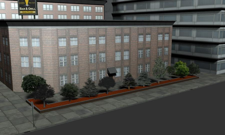

Orienting Trees Towards the Camera
All the trees in River Front and those in the City and Low-Poly Blocks are billboards. These work fine as long as they face the camera but I frequently find I have a camera orientation that catches the billboards from the side at such an angle you see them as tiny narrow things that are obviously wrong. I usually catch this after a render. Plus going through and individually rotating each billboard is a pain. I searched for a script that would do the work for me, and as anyone who has used Daz for a while might expect, mCasual has one that does the trick as long as you make one modification.

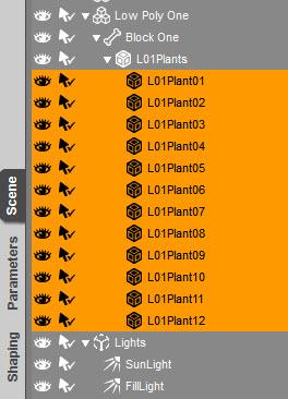

Original Values:
Modified Values:

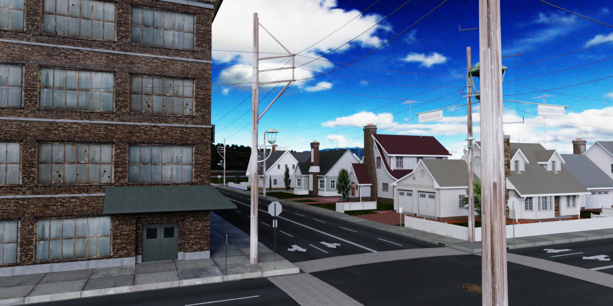

Iray Renders - Night Scene

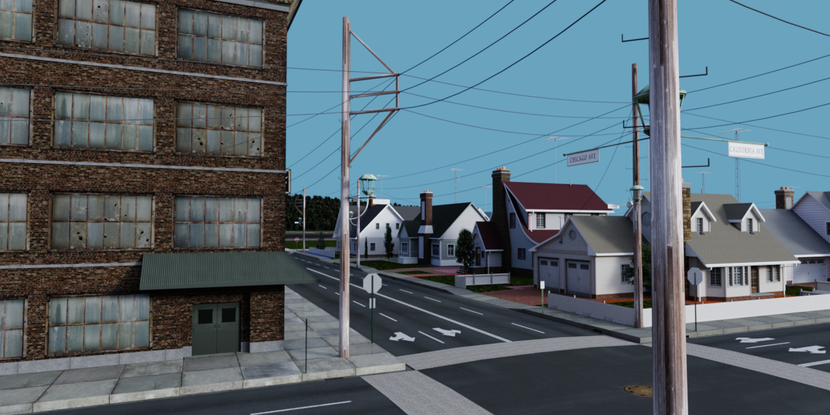

6. Here's where I rendered without a background, leaving the sky transparent, then added in stars from FM Night Builder, a set you can use to add night skies to 3DL renders.
Go to Main Menu
City Crowd - Even Bigger

Vehicles - Tractor-trailers
Click on image for larger view.

Vehicles - SUV's

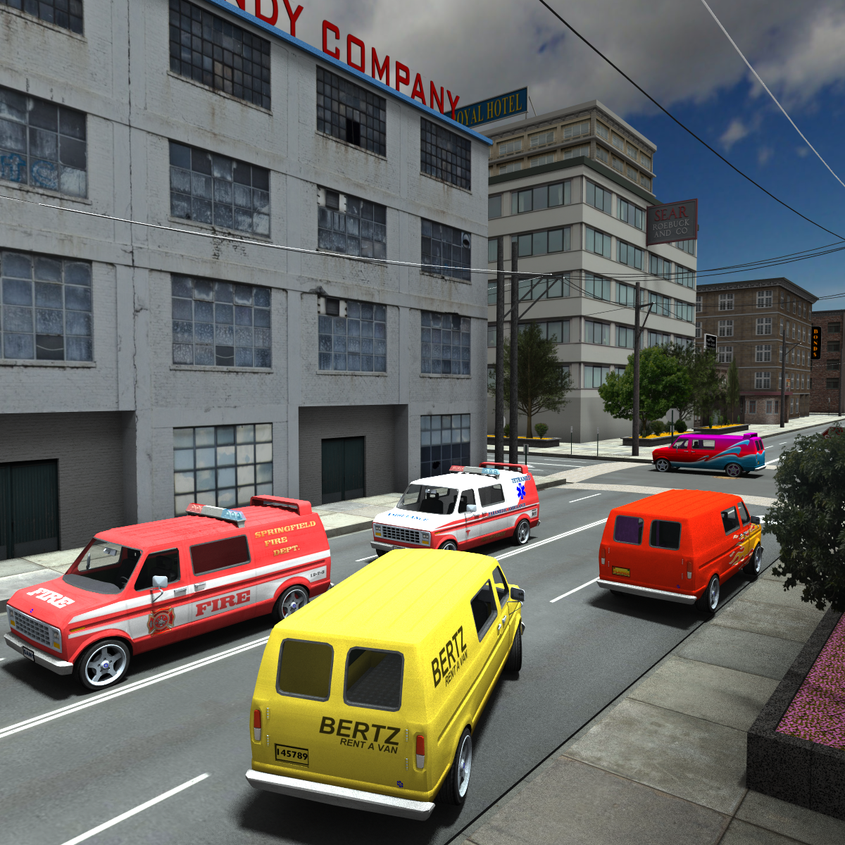

Vehicles - Step Van
Step vans are common, everyday work vehicles in cities. This image shows Predatron's Step Van and Step Van Expansion. The Step Van comes with a white and a blue color scheme, the blue having presets that will open up a side (like a food truck) or the roof. It also has morph dials allowing you to steer wheels, open doors, work wipers and more. You can of course change the color scheme with shaders.The Step Van Expansion adds new exterior color schemes to represent various type of work vehicles (taco truck, news truck, police, SWAT, sheriff, mail, delivery and electric utility) but also includes interiors for several of them (news, police, sheriff, SWAT, taco truck).
Click on images for larger versions.

Scripts and More Scripts!
mcjBBOrient
I have already posted about one of mCasual's scripts, orienting billboards that you can use on the trees that come in Dreamland's low poly and city blocks. I noted one change you need to make to line 148. After using it for a while, I have found that sometimes the change is needed and other times not. I suspect it has to do with the original orientation of the billboard. If you apply it and your billboard disappears, that means it is side-on to your view and becomes invisible. Use the original line 148 settings and it will change back to perpendicular. I also later noted that the script can be used for other objects as well, not just billboards. So if you have a figure you want to turn to the camera, select it in the scene tab and run the script. Remember you may have to change line 148 settings as it may face away from you.
Click on images for larger views.
Ultrascatter lets you use distribution maps to position props. I'm going to test using one to get the props closer to buildings and gutters, since that's where you would see trash more often as it blows or gets kicked around.
