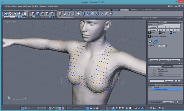

  • SiotradSiotrad Posts: 110
    edited July 2013

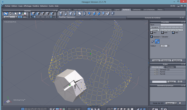

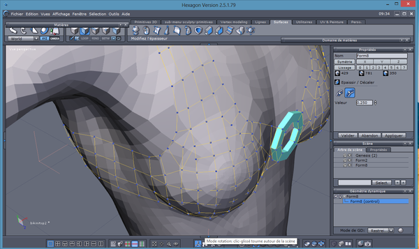

    Yes Fugasi for the Bikini Tutoriel ... and i'm on this Tutoriel .... and have some issue with Thikness.
    I'm beginner and i was happy to arrive to the "thickness phase" but ... When i apply thickness to my top, i have this result ... and i don't understand what it is and why it happened.
    Second and third pictures
    But it work proporly with other things :
    First picture
    So ... i probably did something wrong during the work but i can't understand what.
    So i probably will have to restart a new top but if i can have some help.
    Is somebody have had the same problem already ?
    Thank you and have a fun WE :)
    PS: Sorry for the bad english :(

  • PendraiaPendraia Posts: 3,615
    http://img703.imageshack.us/img703/6421/1fui.png
    http://img577.imageshack.us/img577/514/rm6c.png
    I'm assuming the problem is the thickness of the ring? In the property editor in your image was a box with a number reduce the size of the number in that box.

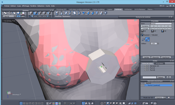

    edited July 2013
    Well not exactly, i forced the thickness ring to show that it work on the ring ;) ... but my problem is that doesn't happene that way with the top ...
    It put me some yellow edge but no thickness ...
    It did the same thing that if i click on "shift" tool .... But i don't know why just with the top ...
    Post edited by Siotrad on
    Okay...let me have a play I'll see if I can replicate the problem.

    Since applying thickness have you clicked on validate? When I did it just now it didn't show up until I clicked validate.
    When validate the thickness attemp ... the top disepear ...
    Okay that's odd...have you got symmetry on?

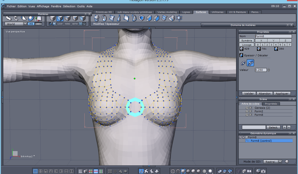

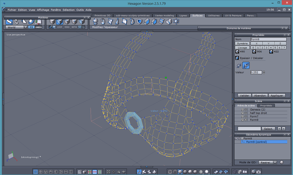

    edited July 2013
    Nop ... and it works yesterday with the "bikini bottom" with symetry on.
    I take an another picture ...
    Top and ring selected ... no symmetry ... click on thickness and that is the result : ... :( ... if validate ... only the ring still there ... The top stay in my "object" but can't see it except his geometrie dynamic control that i can only abort to recovered my top ... (pictures 2,3 and 1) ... i'm not able to put the pictures in the correct order ... :(
    I 'm bored,and make mistake ... can't go back enough to recover the ring size ... i go to sleep ;)
    Thanks for your help and hope you will find ;).
    Have a good day

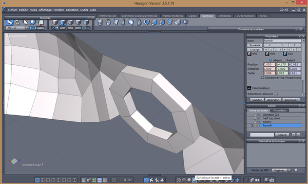

    i think you should weld both pieces so they are one.
    edited July 2013
    Hi again ;)
    I already try copy and past and an other symmetrie ... but it still doesn't work.
    But maybe that is the problem ...
    The firs time a did it (following the tutorial) ... it was not correctly weld in back top and bottom .. but i fix it so why it would be the reason ???
    And anyway, the front is not really weld so i can't understand how it could be the only reason ...
    I take an old save of the first half of the top ... and it was already bad.
    If i weld all parts (ring and top) ... the ring become wrong to thickness so my "one piece" have those yellow edges but no thickness ... at all :(
    For now, i did other way then thickness but i'd like to understand what i probably do wrong.

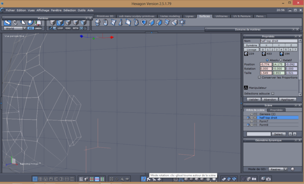

  • dot_batdot_bat Posts: 373
    edited July 2013
    it does not appear to be welded. you still have two objects, form 3 and form 8.
    try as two separate files one for each object and copy and paste one into the other

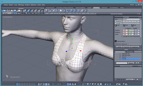

    Well i did not put a picture each time ;) .. but i tried it and it doesn't work.
    im sorry but in each image you show the meshes are not welded together
    edited July 2013
    okayyyy ...
    That's what you talking about ???
    Form 9 is the ring and the top welded ... the others are copy of top and ring.

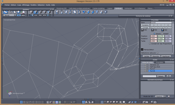

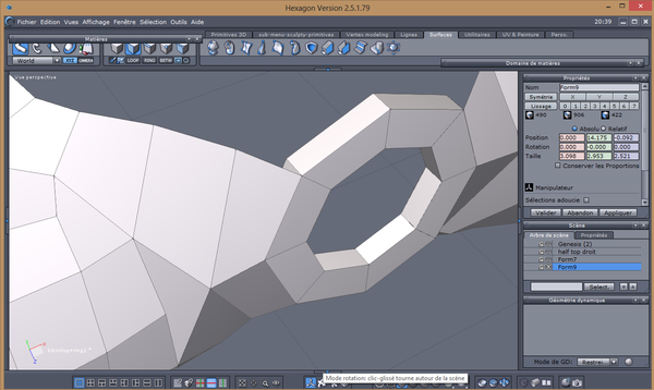

    edited July 2013
    yes now its welded. have you only applied thickness to the ring? can you focus in on that area closer and a orthjographic view screen shot?
    600 x 359 - 184K
    Post edited by dot_bat on
    Like that ?
    1277 x 762 - 191K
    I don't think the ring be the problem but i tried to show it as good as i can :)
    It was (before the weld) 2 parts with some faces superimposed.
    1272 x 762 - 158K
    1277 x 762 - 173K
    1275 x 767 - 154K
    1280 x 767 - 177K
    1266 x 769 - 169K
