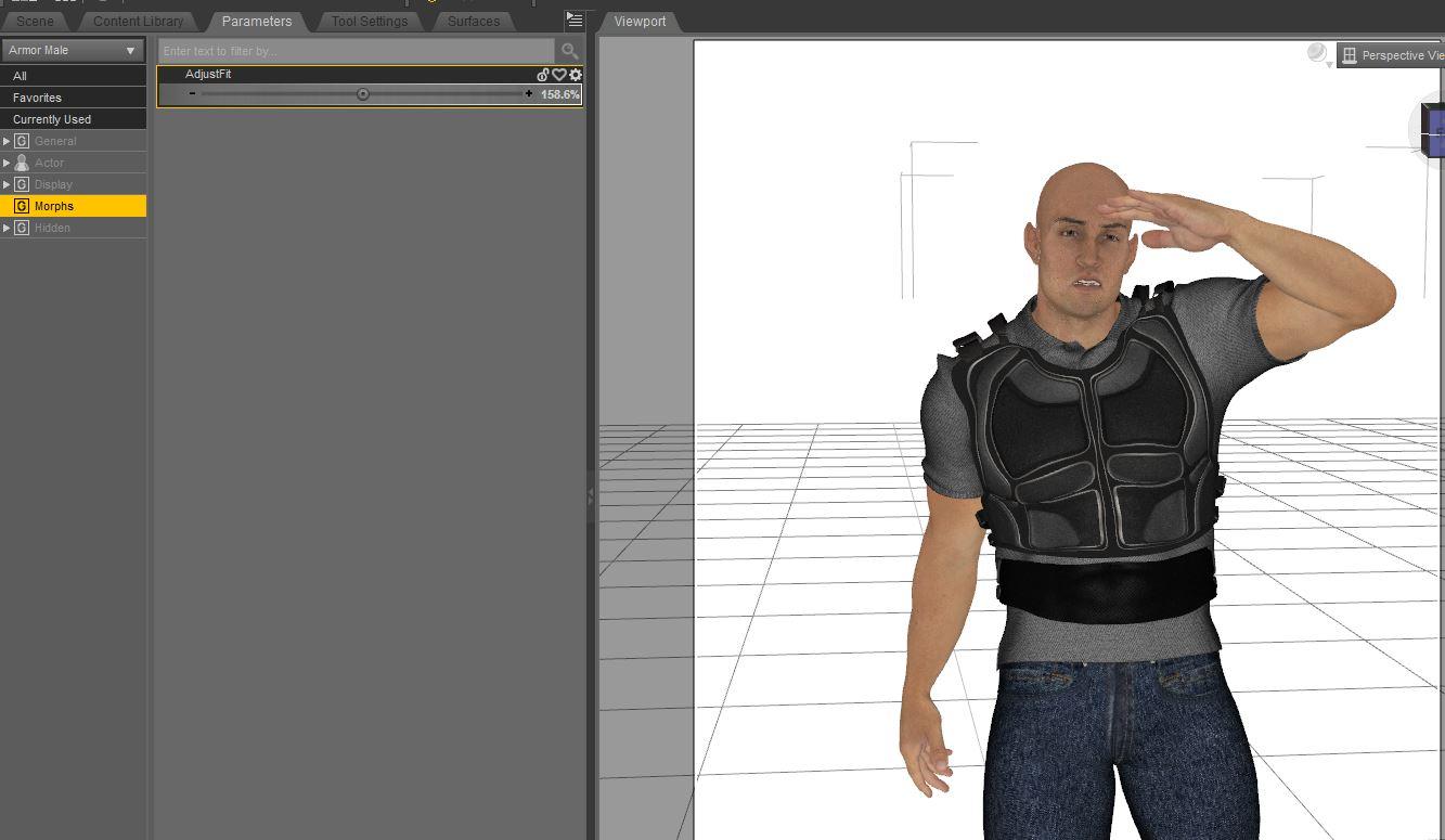

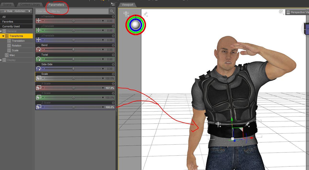

    Okay... the first I found is "Adjust Fit". It's under "Morphs" not "Actor". I'm not sure if you have already used this option?
    The "manual method" would me scaling up different parts of the item. This could also be used to slightly change bendings to make things look abit more natural, or avoid certain types of collisions between shoes and pants, for example.

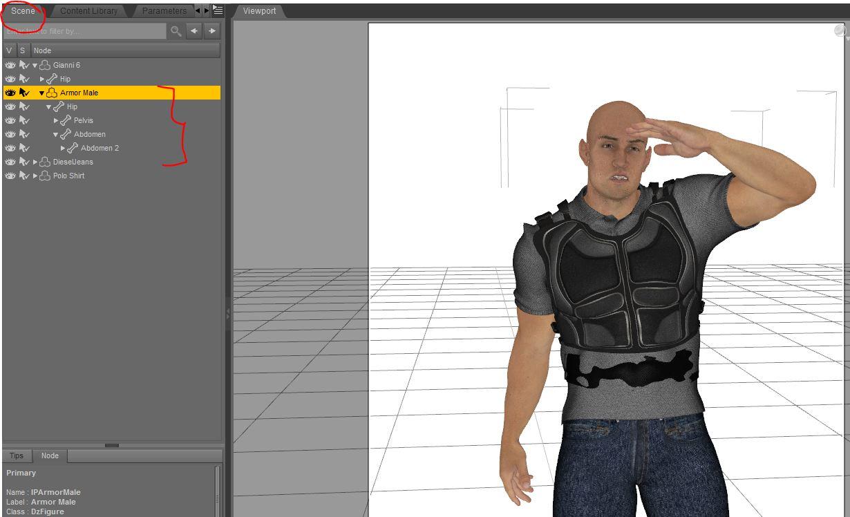

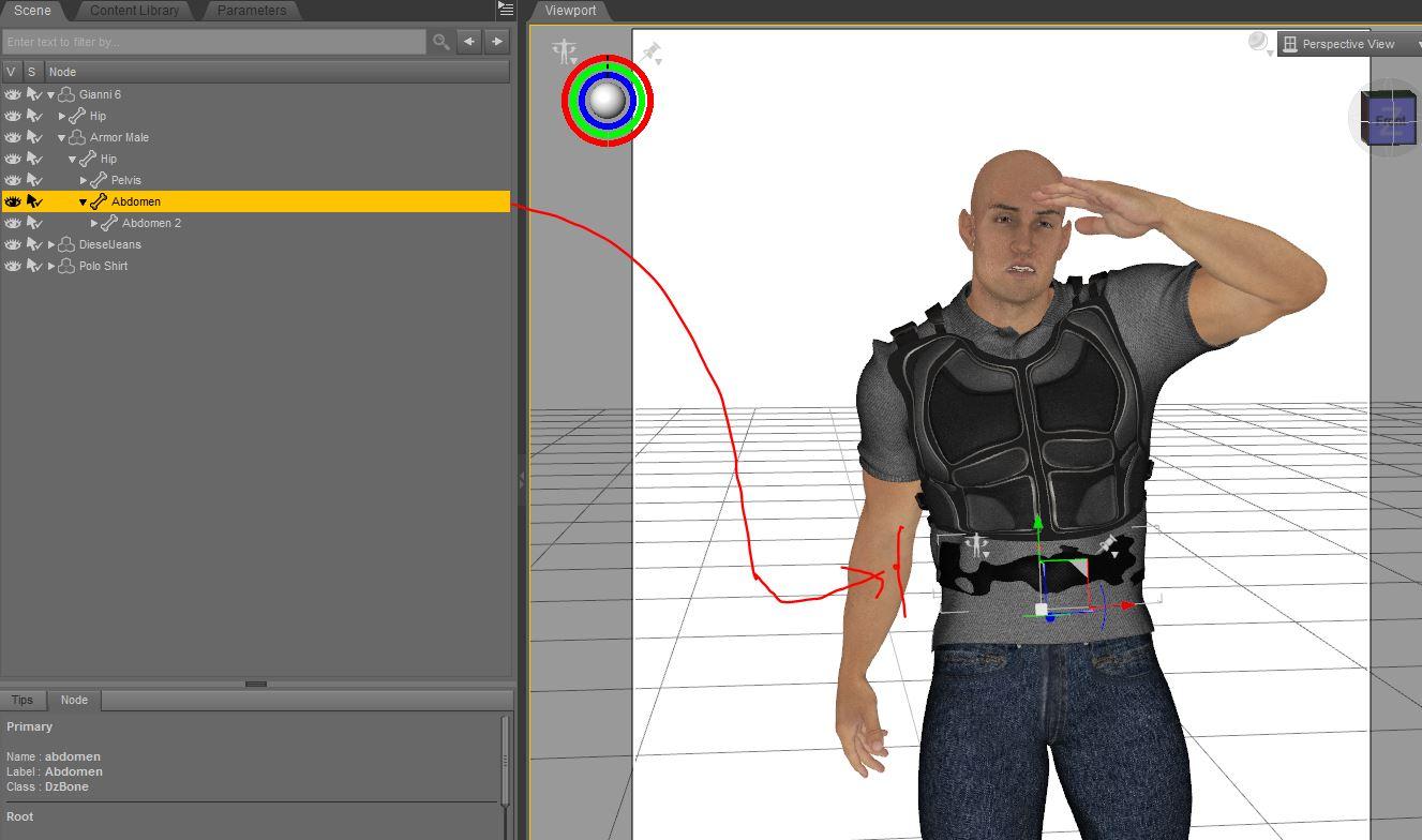

    In the scene tab, select the armor and expand the bone structure:
    The Abdomen is where the belt is located, so I select that bone. You can see which region is affected by the bounding box corners.

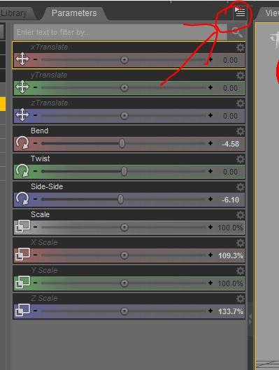

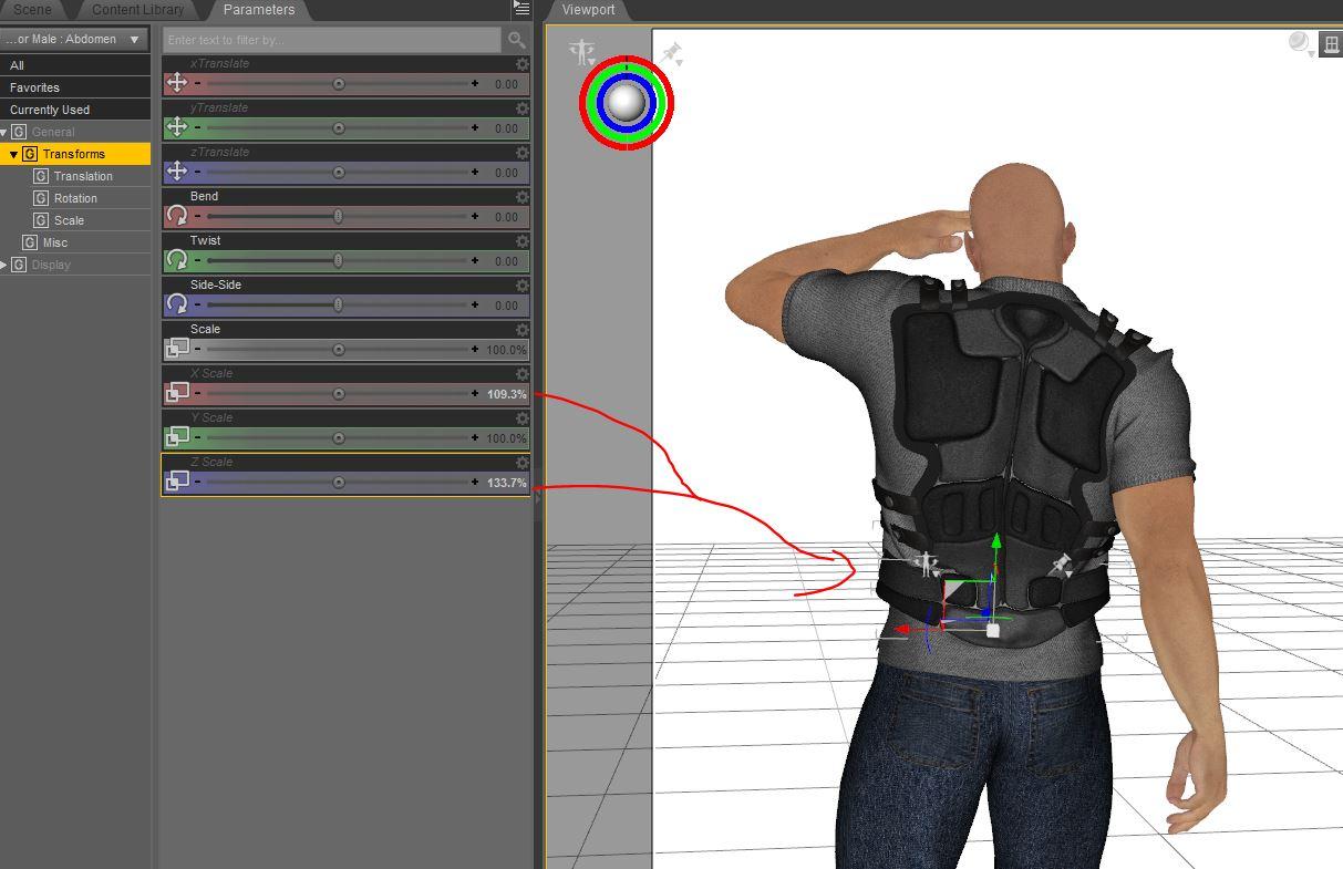

    Changing over to the Parameters tab, I now can adjust the scaling. you'd want to scale the X and Z axis. If it doesn't show, you need to open the hidden parameters by clicking on the listing in the top right corner of the tab.
    The back side needed abit more upscaling. You can use the bend, twist and side-side to change movement of the bone. That works fine most of the time, but sometimes has undesired results, i.e. if you do more than just gentle nudging.

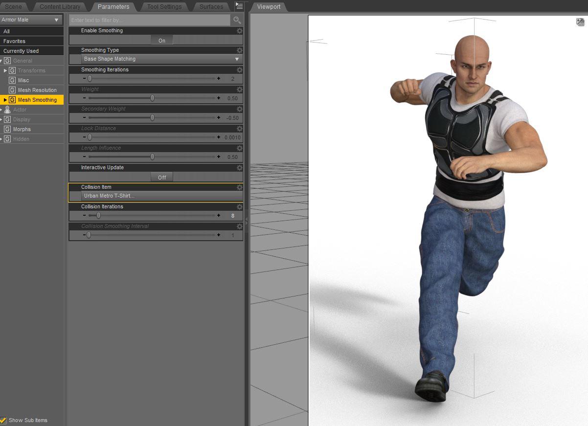

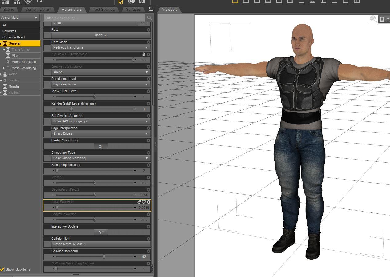

    I just realized that the vest doesn't have the collision option.
    To add the collistion option, in the Scene Tab, first select the vest. Then, go to the selection tab (that's in the same spot where you would select the hidden properties). From the list that opens, select "Apply Smoothing Modifier". This will add the collision.

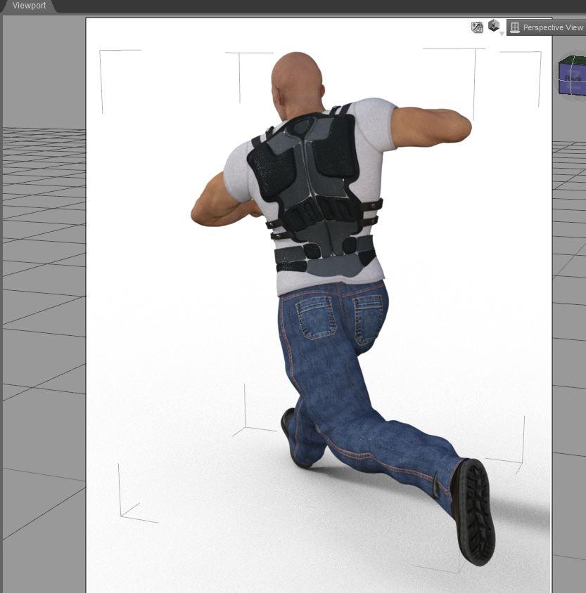

    In the Parameters tab, select "Mesh Smoothing". Change the "Collision Item" of the vest to your shirt. Then, crank up the Collision iterations. It might need a while (up to a minute, maybe longer) for your computer to calculate the collision. You can follow the progress at the bottom of the program window. When it's done, it will show the vest properly. If you use "Adjust fit" prior to that, smoothing will just need a handful of iterations. In my example, I have added 62 iterations, but no Adjust fit.
    EDIT: In a posing test, if I added Adjust fit +5%, I only needed 8 extra iterations of Collision Iterations to smooth out the problem. Of course, if you have strong bump maps on the shirt, you will need more than that.
