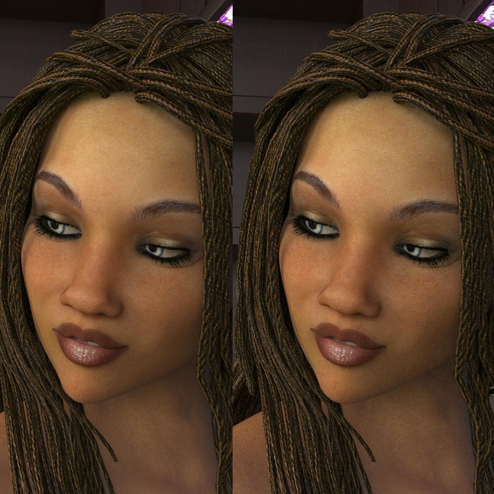

    As I was experimenting with surface skin parameters and lighting anyway, I don't usually but thought I should at least try, I thought I would post this image. The left face has the diffuse map in the Transmitted Colour the right side is without. There is no difference that I can see ( I should point out that the right image wasn't left to render as long as the left one).
    Click on image for full size.
    1000 x 1000 - 1M
    Post edited by Fishtales on
  • 3Diva3Diva Posts: 12,058
    @Fishtales To me it looks like the right one is slightly lighter/brighter. Buy it's subtle.
    I can't see a difference either, but it's worth noting that the translucency colour also influences the effect of the transmitted colour, and in some circumstances kills it completely. Out of interest, I'd be curious to know what the translucency colour was on this character. I've found testing using rim lights most illuminating for seeing transmitted/translucency colour effects.
  • FishtalesFishtales Posts: 6,233
    Redz said:
    AllenArt said:
    Most texture sets I've seen have the top coat set to Reflective, which is going to look really glossy. Fresnel is less glossy and looks more...I'm not sure I know how to describe it...scattered around gloss? LOL. I'm of the opinion that fresnel should always be used as the top coat for skin. Of course, ymmv ;). Nothing I did made as much of a difference as adding backscatter, fresnel to the top coat and changing it from metalicity to weighted. All other changes didn't really do much and if they did, it looked worse ;).
    Laurie
    AllenArt said:
    I pulled the download until I can do more testing and fix what needs fixing...not sure when that will be. I don't have a lot of time to work on it.
    Laurie
    I used the diffuse colour map in translucency colour and set colour to white.

    I've been working on my own skin shader settings based on settings and tips from three different 3D artists that I admire Florentmoon, Bestmanpi, and Will Timmins.
    That's looking pretty nice, Diva! Maybe slightly greenish/cyan around the perimeter, but that could be the color temp of your lights
    Have you experimented with different skin textures or lighting scenarios using the same shader settings? Might you be willing to share your settings at some point after you're happy with them?
    Sure! I've been tweaking it for months and still am not quite happy with it but I'd be happy to share what I've got so far. I'll test it tonight with some different skins/textures to see if it's still viable with others. I've been mainly testing it on my custom textures that I made by mixing V7 skin and the base G3F skin. So I haven't tested it to see if it's viable with other skins. Send me a PM to remind me if you still want the settings. :) I have memory issues and might forget otherwise. lol
