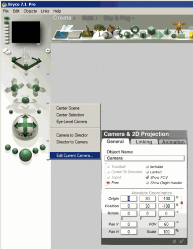

  • HoroHoro Posts: 11,478
    You can control the camera also by entering the parameters you wish.
    543 x 698 - 44K
