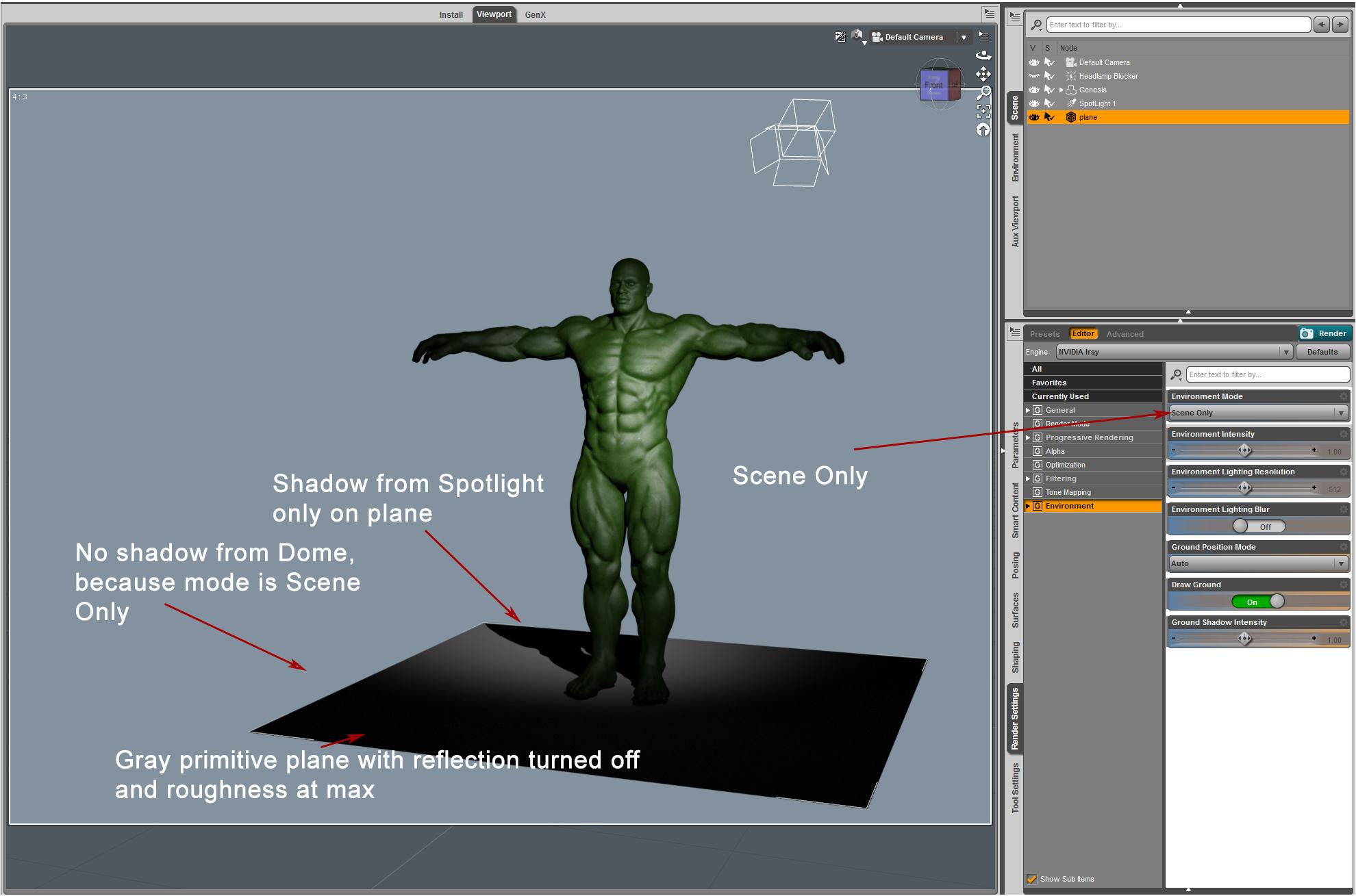

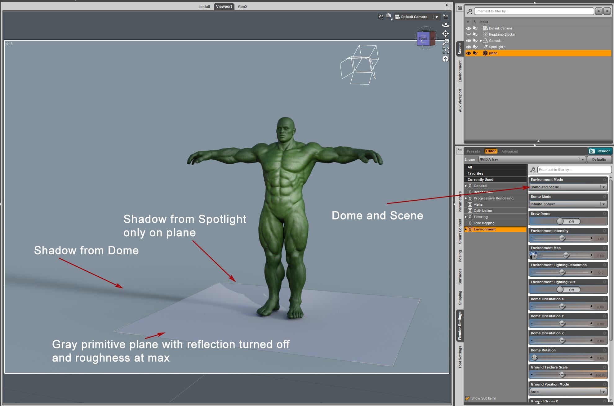

  • barbultbarbult Posts: 27,533
    edited July 2016
    Here is the result of my Iray experiment:
    Note: If I use a white default plane as created by Create>New Primitive...>Plane, the bright dome lighting on the white reflective surface almost washes out the shadow from the spotlight on the plane in Dome and Scene. So I made the plane gray and removed reflectivity to avoid confusing reflections with shadows. Richard mentioned the potential washout issue above.
    Dome and Scene - Dome lighting makes shadow on both the geometry (plane) and the virtual dome ground. Spotlight makes shadow only on the geometry (plane).
    Scene Only - No shadow from dome lighting, because there is no dome lighting in Scene Only. Spotlight makes shadow only on the geometry (plane).  If there were no geometry for the ground (no plane) in my scene, there would be no ground shadow at all.
    Well, I learned some things here.
    1980 x 1309 - 645K
    1980 x 1309 - 576K
    Post edited by barbult on

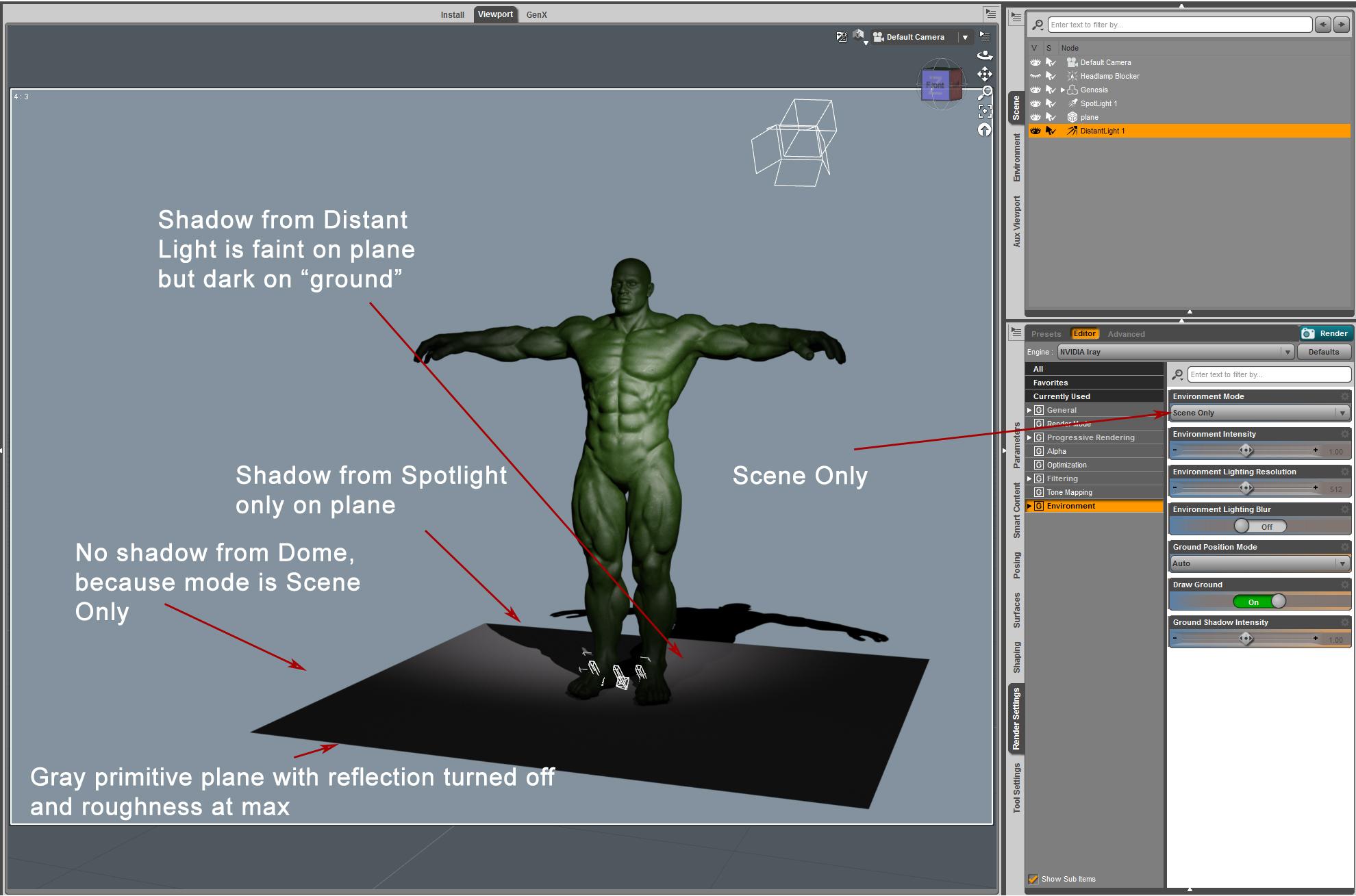

    edited July 2016
    I think I follow what Barbult said...but my confusion is still around the fact that a distant light casts a shadow onto the virtual ground, yet the spot doesn't.
    The scene contains default G2 Female, Basics Wear top and shorts and Cat's Meow hair, and now has a spot, distant and point light(s).
    You are right. That is very confusing. I tried your scene and I tried my scene with a distant light added. The results are exactly as you describe it. I think you should submit a help request to technical support and see if they have an explanation or whether you have found a bug.
    Edit: And another confusing thing for me is why the distant light shadow on the plane is so faint it is almost invisible, but on the "ground" it is very dark.
    1980 x 1309 - 610K

    2. the default lights are never meant to cast shadow on virtual ground. The shadow we get for Interactive mode HDR dome virtual ground is probably just a Daz3D dev bonus. Perhaps, Photoreal are to be strictly "physical" and "consistently literal" - with actual geometries in the scene catching shadows. Advanced users have the option of resorting to DIY Mattes.
    If (2) is true, than my discovery of emissive mesh-spot cast shadow on virtual ground in photoreal (in the previous post) is a hack. In which case, I pray the next update won't disable it. I'm already making nice lamps with it (just in case I actually need to use HDR + virtual ground in my renders)
    I'm betting on {1) though... Things are still being updated and upgraded every 4.8.x.x and 4.9.x.x....
    Even Nvidia is constantly updating their iRay plugins for third party tools including Daz Studio....
    So keey that in perspective...
    I'm just happy I stumbled upon a solution many have been looking for in the last one year apparently...
    This is how my so-called ground-shadow-casting emissive meshspot would look, on a photoreal mode virtual ground, or just plain grey background with Draw Dome off
    Post edited by Mythmaker on
