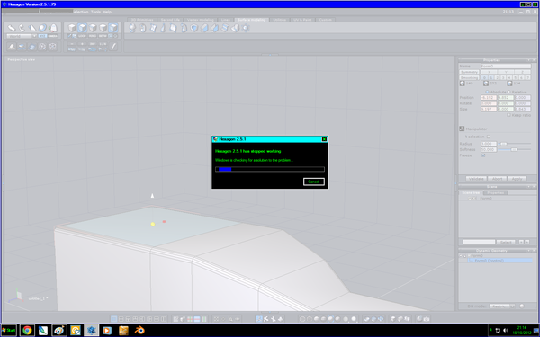

    I'm having real trouble with hexagon at the moment, especially when using the chamfer tool, any suggestions?

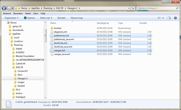

    I'm definitely not a guru, but on a Windows system the preferences are stored in User\AppData\Roaming\DAZ 3D\Hexagon 2
    You'll only need to copy the 3 files preferences.xml, shortCuts.xml and usergui.xml
    If you have trouble finding them (or if you're not using windows) try a search on one of the filenames.

    Hi Blackfeather:)
    I've located the files. If I understand you correctly, what I'd need to do is copy these three files and save them somewhere, then when the preferences get corupted, instead of resetting them, replace them with the previously saved good ones?
    @ genejoke - lots more information, please:)
    What sort of problems are you having? What do you do before and after using chamfer that causes the problem? What sort of mesh are you using it on?
    Some pics would help us in identifying the problem:)

    Roygee said:
    Hi Blackfeather:)
    Yes, that should do the trick if the crashing thingie is indeed a result of the preferences getting corrupted. I'd still reset the settings anyway, then replace the files.

    The meshes are usually fairly basic. I'm trying to make some spaceship models, starting from a cube and extruding and such like. I can usually do it on one edge without issue but doing any more and it hangs. I'm running on windows 7 64 bit with 6gb of ram and a quad core processor. As for before and after... well before I'm selecting the relevant edges and after well it does what it is supposed to but a few moments later it stops and the error message comes up.

    Thank you, BlackFeather - I'll take your advice next time preferences need resetting:)

    Well, your specs are certainly good enough - I take it you have a graphics card to match?
    When you use chamfer, I take it you are using the values input and not trying to do it with the mouse - and that you are validating afterward?
    The problem with using chamfer the way you are doing it is that it causes N-gons on the faces that haven't been chamfered - see my example 3. These need to be cleaned up by joining the verts. I've never had Hex pick up problems with N-gons - except when they are twisted - but some users have reported crashing because of them.
    BTW, you can get better results, cleaner mesh and lower poly count by using extract around and smoothing instead of chamfer.
    My example 1 is chamfered, smoothing level 1 - 680 facets. Example 2 extract around, smoothed level 1 - 512 facets and has a more even distribution of edges - the mesh also looks better than the chamfered one.
    Edit: I notice you have a face selected, so you must have done something after the chamfering before Hex crashed on you?

    yeah I did that one to get a screen shot, in that case I selected the face and bang, it often goes as soon about a second after I hit validate.
