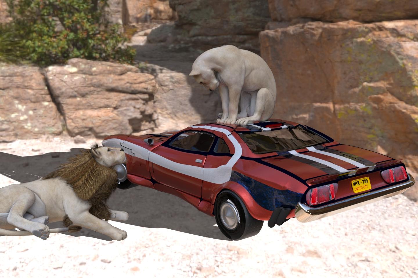

  • FishtalesFishtales Posts: 6,228
    edited May 2016
    With Dome set to on and Draw Ground on gives you a ground plane for shadow catching. The character may look as if it is standing on the ground but select the character and use Ctrl-d to drop it to the ground to make sure. As you can see in this one the lion's back leg isn't on the ground properly.
    Click on image for full size.

  • ScavengerScavenger Posts: 2,677
    Ah.. so the ground plane shadow catches, and the interaction is happenstance of the image sphering around to have a ground.  Got it! Thanks!
