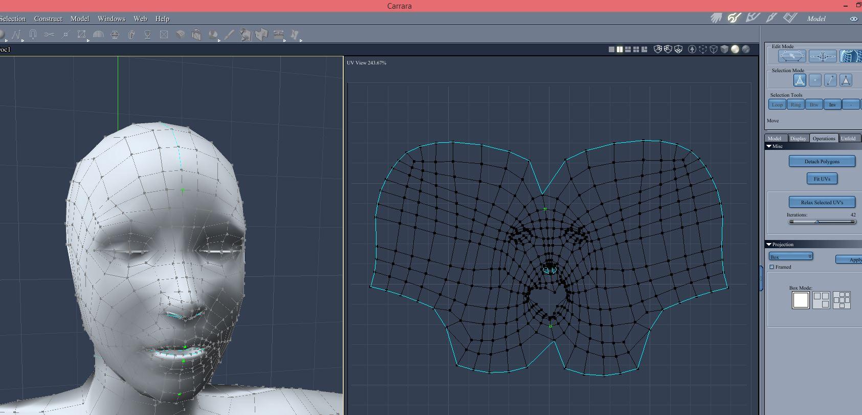

    Would be happy to get some advice for uvmapping and 3d painting.  I used seams to separate most of the shading domains.  I find it annoying that the default unfold comes in extremely small, and unbalanced.  Here is the start of placing the seams and isolating the head shading domain (lips, nostrils, and ears are separate).  In addition to a seam separatig the head from the neck, I have a seam that goes from the rear base of the head vertically up over the top and to about the start of the forehead.  When I use unfold, the left "wing" of the head is out of proportion with the right wing.  Any advice on the placement of a pin or seam to get better results?  As it is, I can paint on the model with relative success but a procedural shader would look unbalanced.  Note -the other body parts and shading domains are not on this uvmap.

  • RoygeeRoygee Posts: 2,247
    Your seams look good - I'd suggest putting pins where maked in this copy of your pic.  What you want is two pins on the centre line, one vert in from the cut.

  • DiomedeDiomede Posts: 15,396
    Thanks, Roy.  That was a great starting point as far as getting a more proportional uvmap.  It did have some odd overlap inside the mouth so I put a pin on the center cut just above and below the mouth.  So far, this is the best starting place.  This screenshot is from the base unfold.  It improves a little when using the relax tool.  This appears like a decent start, and I will try to clean it up more by hand - unless anyone has some more suggestions.  So, to sum up, the head is separate from the neck with a seam.  Likewise, the ears, nostrils, and mouth are removed with seams.  The head has seams along the back-center going vertical over the top to about the start of the forehead, and up the front of the neck to about the start of the chin.  There are 4 pins along the front center seam.  They are one vertex in from the center cuts for the forehead and chin, and at the top and bottom of the mouth.
    More suggestions definitely welcome.
    Hi diomede
    Now that you have a more symmetrical unwrap and I can see what is happening there, a couple more suggestions.
    Remove the seam along the front of the neck across the chin - that is causing a distorted unwrap and overlaps.  All you need is the back of the neck, over the top of the head and across the brow.  The software can do the rest.  See my unwrap - simple and clean.
     Remove the extra pins - they really don't add anything - you only need one in the middle of the brow and one at the bottom of the front of the neck - pins "pin down" the centreline of the UV's so that they can unfold symmetrically - using more than two is pointless.
    Unless you are going to make really detailed textures for the ears, mouth and nostrils, rather not cut them out.
    Probably too late for this model, but in future consider doing your unwrap before smoothing or subdividing - makes it a lot easier to manipulate fewer points and subdividing after the unwrap will not affect the UV's - except make them denser.
    Best advice of all - get a dedicated UV mapper - well worth the investment:)
    1600 x 900 - 297K
    Thanks again, Roy.  It is not too late.  I have the incremental version of the model just before adding the density that you see in my screengrabs.  No problem going back one step.  This is the comic proportion version.  I also started a toon proportion version, so I may not even use this model.  But either way, I am using the challenge as an excuse to practice/learn to use seams and pins to uvmap a head instead of starting with the sphere preset. All of your suggestions will help me no matter which head I choose, and are greatly appreciated.
    Roygee said:
    Hi diomede
    Now that you have a more symmetrical unwrap and I can see what is happening there, a couple more suggestions.....
    ...Probably too late for this model, but in future consider doing your unwrap before smoothing or subdividing - makes it a lot easier to manipulate fewer points and subdividing after the unwrap will not affect the UV's - except make them denser.

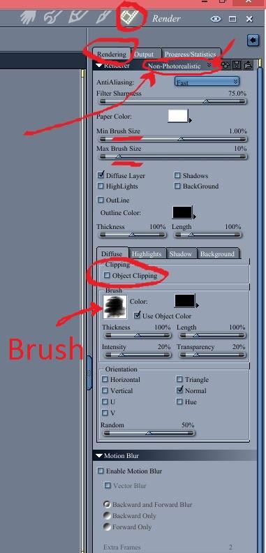

    Here are a couple of general points about non-photoreal rendering (NPR).  NPR is chosen in the render room instead of photoreal, and then a new menu appears for render settings.  The NPR render is based on simulated brush strokes.  Brushes (square greyscale images) are chosen to determine the density, darkness, and transparency of the brush stroke (I probably said that badly).  The length, thickness, and randomness of brush strokes are also chosen.  Separate brushes can be used for the basic color(diffuse), shadows, outline, background, etc.- or any of these elements can be excluded entirely.  The strokes can be contained within object boundaries by choosing "object clipping."  The NPR has some limitations.  For example, it does not handle dynamic hair or transparency.
    To illustrate, I loaded V4 and V3 models and applied some conforming clothing and a generic pose.  I applied dynamic hair to V4 and a prop hair to V3.  In the default standard photo-real render, you can see the dynamic hair on V4 (which I have not tried to optimize - sorry vendors).  The prop hair on V3 does not look very realistic.  The eyelashes of both V4 and V3 look standard.
    The non-photo real choice is found in the render room under the rendering tab.  There is a drop down menu for draft, non photorealistic an photorealistic.  There are a lot of settings to explore, but I want to emphasize the sliders for minimm and maximum brush size and the check box for object clipping.
    The default settings for the NPR render engine looks smudged.  The noses look flattened, the fingers look bloated, and the dynamic hair doen't work.  In addition, the eyelashes completely obscure the eyes.  This is in part because the NPR has trouble with the dynamic hair and transparency (for the lashes and corneas).
    I am no expert (yet) on the NPR, but there are some simple settings to improve some of the results.  In the following, I selected the eyelashes and corneas and moved them back in the head.  I reduced the minimum and maximum brush sizes.  I checked object clipping.  I reduced the amount of randomness in the brush strokes.
    When intending to use the NPR render engine, I try to anticipate problems with tansparencies, dynamics, etc.  In the past, I have tried combining the NPR render engine with results from a modified toon render.    Mixed results.  More experienced Carrara-ists have created their own brushes and used multi-pass rendering (rendering with identified sub elements like object index pass, or ...pass), and then combined the results in an image editor like Photoshop or Gimp for great results.  I think if you look through some old challenge threads, Antara showed how to create custom brushes and isolate render passes.

    Some great WIPs coming in late.  Atlantis seems like a great fit, shlomi laszlo.  Msteaka, your wake looks excellent.  I hope you explain how you use particles for the spray (metaball?)   I hope there aren't any dinosaurs on that scifi planet, Wgdjohn.
    Here are a couple of more observations about the NPR render engine.  First, the two renders illustrate just how different the look can be if you use a scratchy brush compared to a dense brush.  You really can get a wide variety of styles by varying the brushes.  Second, you can see some glowing white areas.  These are places where the camera is seeing the back side of the mesh.  In the case of the clock, you can see in the third render that I fixed it by selecting the polygons and reversing the normals.  Now the fire primitive isn't showing up the way I want.  I think I can adjust for that, but in the meantime I inserted an ocean and reduced its size and merged it with the water in the tub.  I plan to adjust the shaders to make it look like soap suds and bubbles.
    EDIT - the third render is not loading at the present time.  Suffice it to say that it is like the second pic except the clock looks better.
    800 x 600 - 139K
    800 x 600 - 41K
