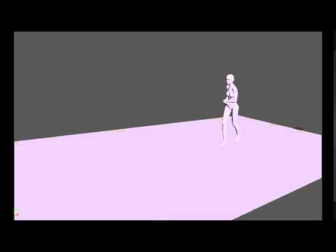

  • ToyenToyen Posts: 2,044
    So long story short, we lack a proper animation rig and therefore animation becomes a very painful process.
    I animated this walk cycle in maya and I cant really imagine how I would do it in DS with no rig controls and no real IK/FK options.
