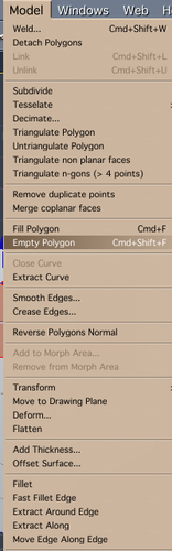

  • DiomedeDiomede Posts: 15,462
    Also, and this might only be in the pro version, there is an icon along the top menu of the vertex modeling room that looks like a sideways H with a skeleton inside. If you hover your mouse over it, it will say quick filet. There is a little triangle on the icon. If you click the triangle you will get four choices for manipulating lines. One of them will allow you to choose a line and then create a new line and drag it anywhere along the polygon of the line it was copied from.
    Not sure if that made sense, but play with the choices in the quick filet menu, if you have the pro version.
    yandris said:
    Yes, have the pro, but the "Fillet tool" or the "Extract ... tool" will only work on simple meshs like the cube, but if i have a mesh that is not symetric and have different sides or whatever, than i have no lines to select to duplicate and move along. in Maxon C4D there was a Tool "Knife" or "Cutter" (can't remember) for this.
    Thanks
    Yandris
    Ah, yes, the cut tool, or lack thereof. The real experts will now have to weigh in.
    To your first question, if you don't want to use the 1/2, 1/3, 1/4 position choices when adding a new vertex for a new line, there is a checkbox in the properties tray (upper right) where you can change the setting for add vertex from "constrain position" to "free position." You can then add a series of vertexes wherever you like.
    As for a cut tool, you will not be as satisfied with the choices in C8.5 compared to Hex. You can select a line and use the filet tools as discussed above. You can also be creative, such as try to use a temporary mesh as a boolean and cycle through the boolean choices until you get the line option, instead of the union/intersection type choices. What might work depends on the characteristics of the mesh that you are trying to cut.

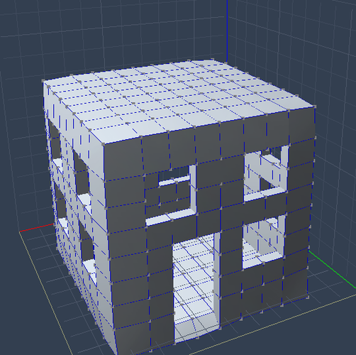

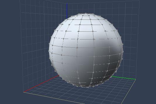

    Yes, there is a cut tool and I am posting some pics.
    Use the polyline in one of the directional camera so you get a flat drawing plane. Draw the cut. the cut tool and the boolean tool are under the same tab in the vertex modeling room menu. The choices of how the cut works are in the properties tray on the right.
    You won't be as satisfied as with Hex, so the Hex people keep saying.
    Note the choice on the far right is split surface. it is the choice that will simply add lines to your mesh. Always confirm that you have not inadvertently split the mesh. Check in the lower right area of the properties tray where it says how many vertexes there are. It should still say 1 mesh.
    If I understand the critique by users of other programs, the cut tool is again limited by instances in which you intend this "through the mesh" cut, which is why I mentioned other creativity.

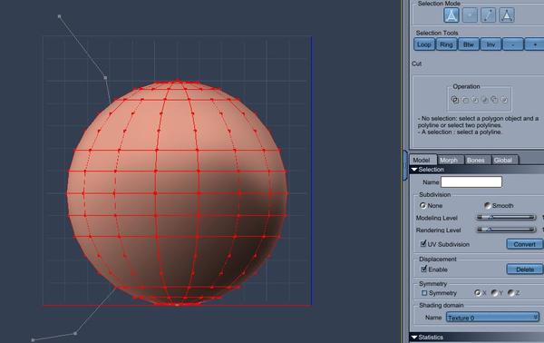

  • tbwoqtbwoq Posts: 238
    edited March 2014
    The vertex 'Cut' tool is the same as the regular boolean function except that it uses polyline/closed polyline to boolean a polymesh volume(as seen in diomede64's screen shots). Carrara doesn't have an automatic loop slice or loop tesselation. It has to be done manually by selecting edges and subdividing or linking vertices etc.

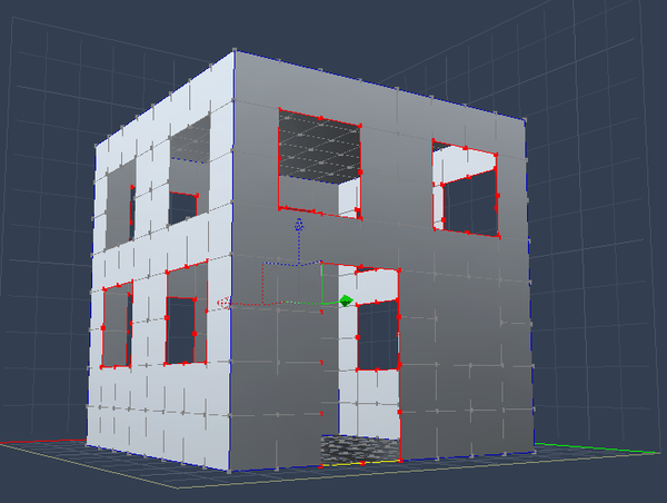

    I guess I mis-read the name of the tool I was looking at. It's the little scissors icon and it's called the Delete tool. I can use it to make clean holes in a mesh without booleans though.
    I started with a vertex cube and deleted points to make larger oplygons for the doors and windows. I then selected the polys for the doors and windows and selected Empty Polygon from the Construct menu. I then added thickness, but it made the outer walls puffy looking so I tried creasing the polys first. It was a bit better, but still a bit puffy around the corners. I have an idea I want to try to get rid of the issue.

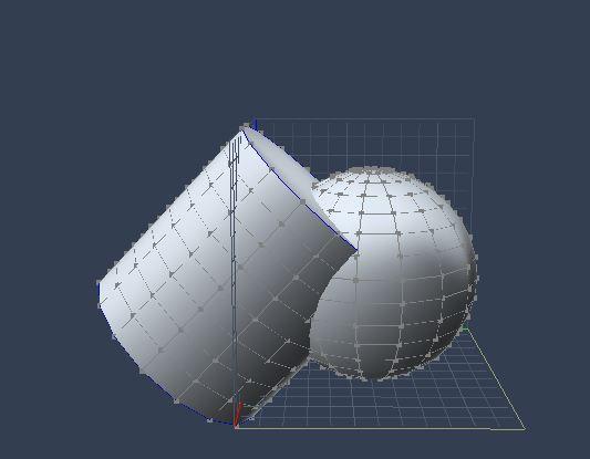

    and here is an example of using boolean, because you can get more creative in 3D space then with the simple polyline. Hopefully you can see the yellow line on the sphere. With the boolean, you might have more exact ability to include or exclude sections of the first mesh by manipulating the shape of the second mesh compared to if you used the polyline tool.
    There is a whole backstory of to the cut tool conversation that we shouldn't go into here. Suffice it to say that you can get creative with boolean to try to address asymmetrical meshes or complex selection areas, but the cut tool itself gets a lot of grief.
