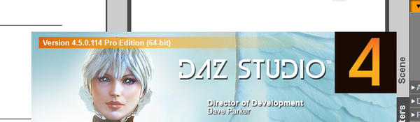

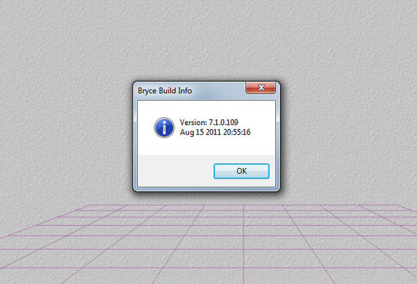

    First thing to check, that you are working with both the latest version of Bryce (7.1.0.109) and DS 4.5?
    736 x 215 - 64K
    642 x 438 - 150K
    The latest DS is 4.5.1.6...
  • David BrinnenDavid Brinnen Posts: 3,136
    Oops. Out of date already... Still, it does work.
