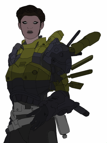

    People generally won't look very good with the VectorStyle exporter, in my opinion... Certainly you lose most detail and shading... But I typically do not find *any* vector drawings of people to be very attractive.
    A stylized or "toon" figure might give good resullts, but it depends on what you'd find acceptable detail...
    I'm attempting to export a figure in a few formats... in the meantime these images are from the Docs:
    885 x 209 - 37K
    419 x 263 - 30K
    699 x 541 - 77K
    You can download 2 vector exports here:
    http://www.3d.wetcircuit.com/xtra/Alex.eps
    http://www.3d.wetcircuit.com/xtra/Alex.svg
    This was just a scene/figure I had handy. I have not changed textures or lights to try to improve the results.
    Here is the EPS. I set the export background to white, but it did not take, apparently...
    632 x 795 - 124K
    ...and the SVG
    all vectors are selectable and editable in Illustrator.
    505 x 677 - 74K
    505 x 678 - 115K
    For comparison this is the figure rendered with Carrara.
    768 x 1024 - 58K
    Boosted Ambient Light to 50%. Turned off shadows and highlight in the exporter, with quality setting at "Best" and fill set to "Gradients". I have transparency turned on but clearly there are issues with the eyes and lashes.
    631 x 868 - 265K

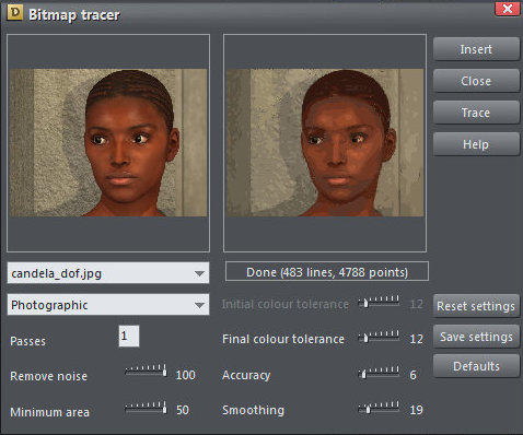

    Hi Head Wax :)
    Have you tried Xara. ?
    It has a really nice little built in Utility to convert images into vector shapes (Bitmap tracer)
    nice sliders, and options to control what you end up with.
    it creates the result as a "Group" of vector shapes, so you can move and scale it easily, but you can "ungroup" it if you want to edit the individual vector shapes, or delete what you don't need.
    30 day trail at Xara.co.uk,.... so it's worth a play
    I'm using Xara Designer Pro X here.
    500 x 811 - 56K
    502 x 762 - 63K
    478 x 398 - 47K

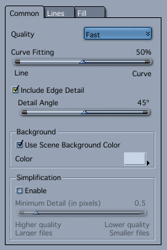

    Hi
    I've got another question which relates to Vectorstyle 2
    It looks as though like similar plugins I've seen you can control where lines show by using smoothing groups. Is there a way to change the smoothing groups on a model already in Carrara?

    VectorStyle has a parameter for edge detail that is controlled with an angles setting. The setting is universal so it works for all the export formats.
    241 x 361 - 27K

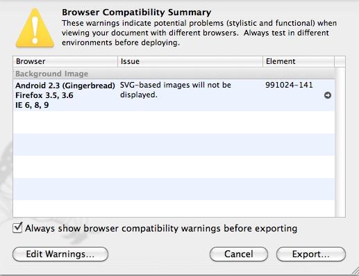

    Anime Studio Pro has some useful features including
    1) ability to autotrace bitmap images into raster images and vectors
    2) import Poser scenes to create toon style animations or images (see post)
    3) output to different formats including SWF
    The "toon" style Poser output from Anime Studio is on the low quality side but works okay for certain scenes.
    And if you are a Mac user and want a way to convert SWF animation output from Vectorstyle2 there is another software called ElMedia Pro that will take a SWF movie, and convert it to image sequences. You can then assemble those as Quicktimes in Motion5 or Quicktime Pro 7. This works generally better than the buggy Swiffy service from Google.
    263 x 345 - 11K
