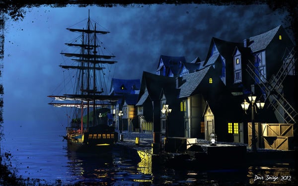

@Terry: The one thing that catches my eye is the edge of the terrain in front and to the fore side of the houses. Those areas would look better feathered toward the road and beach(?) using the Terrain Editor, or by lowering the entire terrain until those edges are even with the road and beach(?). The sky and lighting doesn't look quite right to me for the scene, but I lack experience on how to adjust them.
David has an excellent short video tutorial that deal with creating an easy shoreline scene with convincing waves.
I'm sure he'll be along soon with a link for you on that or you could go check the list at the top of the sub forum. :)
As for the street light... Adding lighting to night time scenes can be complex so it's not going to be easy to give anything more than general direction on it. There are old street lights available on ShareCG and usually only require a Bryce light to be inserted inside them as I have done in this render, and then the light edited until it gives the effect you want. :)

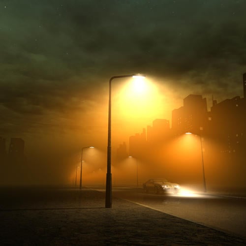

Bryce 15 minute lighting project - low pressure sodium lights on a foggy night - by David Brinnen
