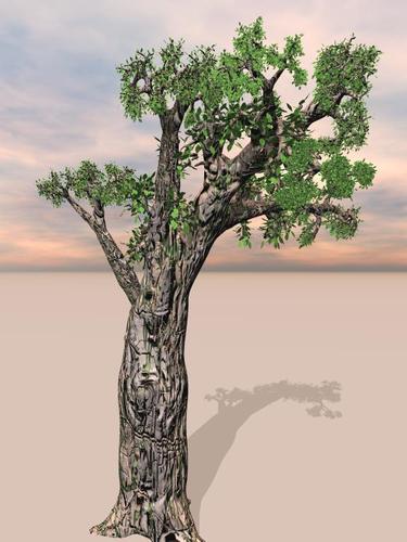

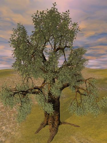

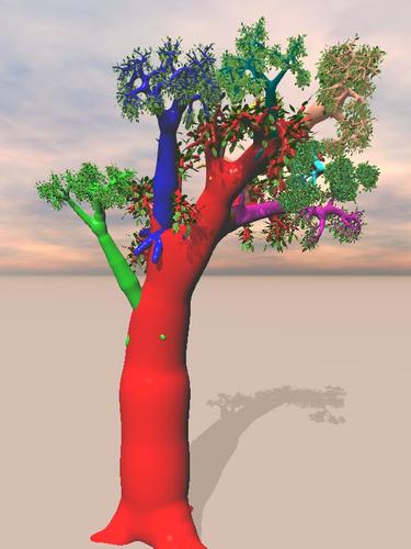

    BTW addint to that, I have a habit of making composite trees by using several bryce trees.
    I show here a tree, and how I made it up from several trees, and also another one I tired to get a "pollarded" tree. I build the roots up with metaballs.

    This is what I mean by building trees up. You can see why I need to get rid of the roots.
    Oh, I see. That's a cool idea to build trees. Never thought of that - though I did combine trees at the trunk level to make them more realistic. Boolean the roots off doesn't work, at least not for me. Trees are made of metaballs, but they cannot be separated, which would be helpful.

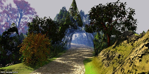

    Meanwhile taking the photo Chohole posted of the country lane with overhanging trees, I knocked this quick scene up (it took an hour to set up and 30 minutes to render using Premium, TA and soft shadows at 4RPP and Max Ray Depth at 1 hence the noise).
    It's only rough, I only did it to give an impression of what can be relatively easily set up. Given more time (and I may work on it more because I think it's looking good[ish]!) I could look a lot more realistic. But if anyone wants or needs to know how it's done, I can go into details. :)
