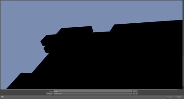

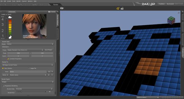

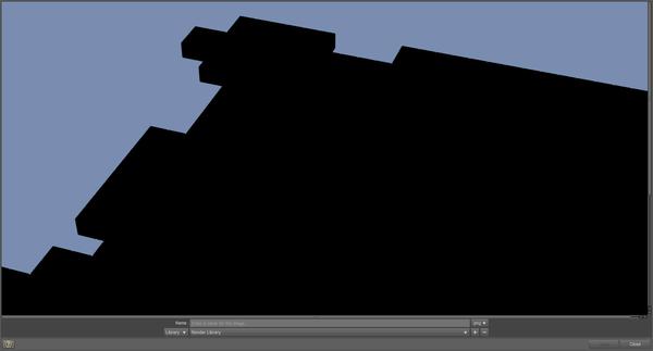

So I am trying to get this scene to render, if I use any render setting other than 3Delight it renders correctly but when I use 3Delight the object in the scene just appears as being all black, no color, no texture. I don't think this is a lighting issue because the lights render fine on the other settings. BTW this is using an imported Maya file, but I tried converting it to several other formats and I get the same result.
using Daz Studio 4.5 Pro
«1
    First of all, the other render options are not really renders as such, they use OpenGl and display what you see in the viewport.
    Are there any lights in the scene? DS has a default light which is in the camera position, but if there are any other lights in the scene, that is removed. Try creating a distant light in DS4.5, and see if that works.
    Can you post a screensot showing your scene, and the scene tab so taht we can see what is in it.

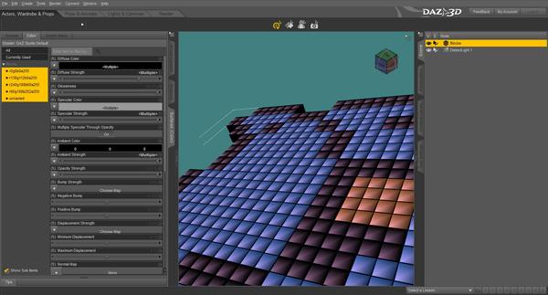

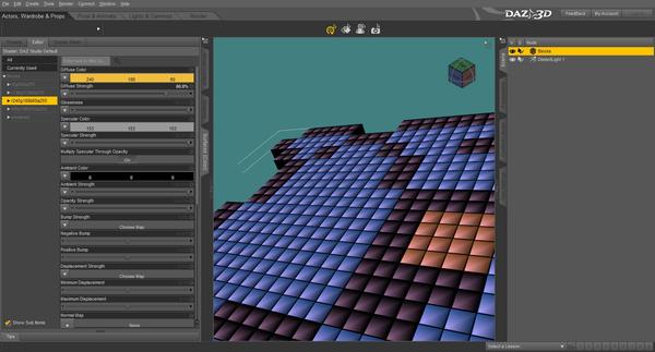

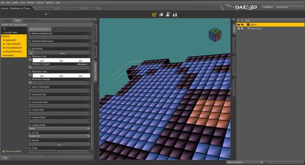

    Select the Object in the Scene Tab and then open it in the Surfaces Tab, pick one of the mat zones and Post a screen grab of all the settings. I'm sure when can figure out what the Issue is. Even if it is not in Surfaces but I really wish to check that first.
  • MEtaLpREsMEtaLpREs Posts: 0
    this is all the surface options
    1600 x 864 - 163K
    1600 x 861 - 161K
  • JaderailJaderail Posts: 0
    Thank you but I asked for just one ZONE to be picked so I could read the settings on each area. The way you did it I get Multi in many of the settings. In the Surfaces tab just select the top area listed not all of them at one time.
    yea as soon as I posted that I realized that I had done that, completely my fault.
    1600 x 860 - 155K
    1600 x 860 - 162K
    Looks like 3Delight is rendering it correctly, according to the settings...
    Your light source is not 'on', not strong enough or pointed the wrong direction, so it is rendering as it should with an Ambient color of black at 100% strength.
    Turn off the ambient strength (drop the slider to 0)

    So illumination is set to "on", double checked that it is pointed in the right direction, even tried the "point at" option and selected the object, set the ambient strength to 0 on all parts
    rendered the image again and got the same result as before, just solid black.

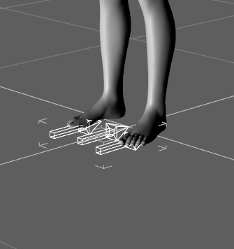

    One your Light is not Pointing at the Object properly I think. Two with Ambient set to Black and 100% it will be Black (change Ambient to white and 0%) When you load a Distant light it points across the default load plane at zero elevation. You can do the LOOK through the Light trick to make 100% sure the light is pointed at the object. I think your light is Behind the object at this time. The light and Camera both need to be on the same side of the object.
    This is default load for a distant light, see how it is across the plane? It will need adjusted to point at the object.

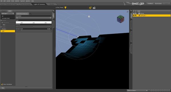

    I changed the ambient color to white, set the ambient strength to 0, chaged the distant light to a white spotlight so it can clearly be seen pointing directly at the object, I render the image again and got the same result of the object being solid black like before.
    1600 x 860 - 75K

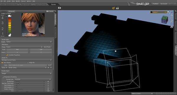

    Your last Screen image shows just the upper left of the object with light falling on it. When you hit the Render button are you looking through a CAMERA or the default Perspective view? You will need a CAMERA. Some versions of DS did not create a Camera you had to do it yourself. The Perspective view will not render properly, a camera must be used. I wish I was more help.
    so with all the previous settings still at what they "should" be at, I created a camera and as you can see the scene is being viewed from the camera not a perspective view, i used a spotlight as opposed to the direct light so it would be clear where the light is and is not striking the object. when I render you can see that it still is rendering solid black only.
    1600 x 860 - 34K
    1600 x 861 - 114K
    edited October 2012
    Did you CHANGE the Surfaces setting as well before you rendered? Ambient at White and 0% for the render? That is my only guess, without being able to test the object myself that is my only idea. It should work, I use many none standard objects in my art.

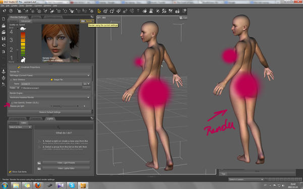

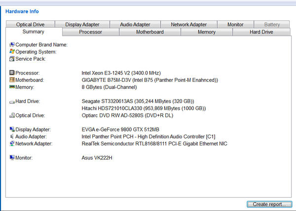

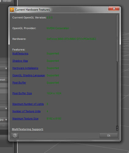

    Hello, I am new user and I have the same problem. Only I am sure that file is not corrupt. It seems that it doesn't render texture. Maybe it is problem with OpenGl, I can render on 2 level settings and only when I unchek OpenGl. Is it problems with some kind of settings or my Graphic card is outdated. BTW it still performs really well in other programs.
    What problem exactly are you having?
    What does it say about your graphics card in Help > Troubleshooting > About Your Video Card?
  • spindzele020spindzele020 Posts: 10
    I can not render with 3Delight an can't figure out why. I can render when I put inseting tab 1 or 2 level of Quality. Below is information about Graphic card.
    531 x 630 - 121K
    The fourth quality option in the Render Settings pane is for 3Delight, are you saying that you cannot use it?
    You video card is only used to display the items in the Viewport, and is not used for Software Rendering (3Delight) at all, so the video card is not the problem.
    What OS are you using, and is it a desktop or laptop system. What happens when you set the slider to 3Delight, does it render or not?
    Does it say anything in the log file, Help > Troubleshooting > View Log File?

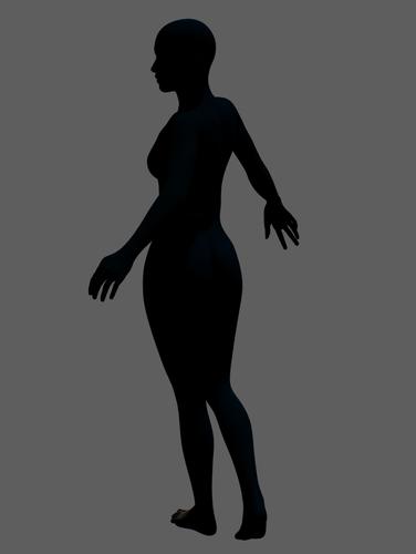

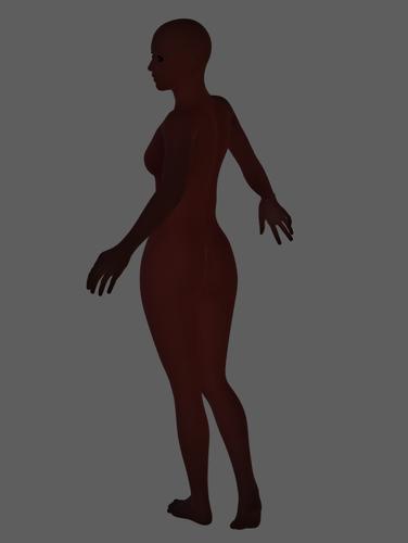

    Ups , forgot tu mention that I am using desktop computer and ven I pres View log file nothing shows up. I atached last render with slider to 4 level and I got something vierd. Veeeeeeeel with Maya was easier to render, but slover.
    671 x 893 - 61K
    This is render with second level seting. Note that I unceket openGl, becose if I chek it it turs completely black. Aded pink blobs for modesties sake :D
    1680 x 1050 - 549K
  • Richard HaseltineRichard Haseltine Posts: 111,852

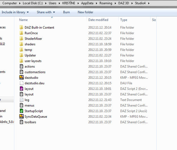

    I suspect that tdlmake is not running, or is completely missing. Either that or something has corrupted your shaders or replaced them with incompatible versions - did you, for example, try installing the stand alone version of the Elite Human Surface Shader?
    The log file is in C:\Users\You\AppData\Roaming\DAZ 3D\Studio 4 for Windows 7 and Vista - you will need to enable the display of hidden files and folders through the Control Panel Folder Options applet to see that.
    About instaling "... stand alone version of the Elite Human Surface Shader.." WAT??? and where , I will try everuthing , but as I am new DS user Ifeel like scrambling in dark. Below is image of folder content
    667 x 566 - 214K
    No, installing a stand-alone shader might have replaced a working version with a bad version so it's good that you didn't. The log file is there in your screenshot, so try doing a 3delght render, then open the log and scroll to the end to see what, if anything, it says it had trouble with.
    I think I cannot open it when I click nothing is hepening no log file is opening ( Troobleshooting > View log file). I thot that seperate windows wil show, or maybe I am dooing something wrog
