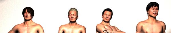

    Below is a test render I did a while ago of the Ethnicity:Asian males heads. Male A, B, and C left-to-right in order, all using the Lee Elite texture on Genesis. I used all three heads at full strength to see what the differences were. The last one in the line is Lee Elite M4 himself (an actual M4, not a GenX transfer, in this case). I'm guessing from context that this is probably the one you bought without having the Elite Ethnic morphs for? Anyway, hope this is useful.
