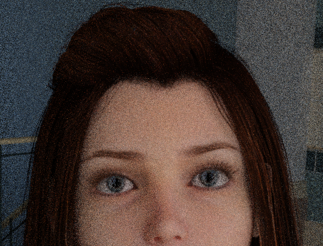

i am having a strange issue with Seema Hair seeming to leave what looks like a shadow on my characters forehead, that shouldnt be there. It looks like the scalp geometry part of the hair model (which is invisible via transmap) is leaving a shadow. Its fine if i hide the full hair model, and only seems to happen when there are lights near the characters face.
I have looked at the transmap and cant see anything wrong with it, i have tried playing with the collision and smoothing values, and i have tried sending character and hair to zbrush and manually pulling the scalp part of the hair away from her forehead, and pulling it back into her forehead.
example image attached
Anyone have any ideas why this is happening?

    Is this Iray? It looks as if the hair skullcap isn't quite transparent - find the Cutout opacity setting in the Surfaces pane for that surface (if the hair has only 3Delight shaders you will need to apply the Iray Uber Base first), then click the image thumbnail to get the menu for picking an image, click Image Editor and make sure the gamma value is set to 1.

    It is indeed iRay. I tried your suggestion richard, and the gamma value is set to 1 on the trans map, so this is not the cause of the issue.
    I turned off the headlamp on the camera, and it was no longer having this strange effect, but the only light that was then in the scene was ambient and not really illuminating her face properly. I then added a spotlight to illumate her face to test, and the spotlight brings the issue back, so its definitely something to do with a shadow.
    But also interestingly, i created a new scene with just this character in the default pose, added two lights and rendered close up to the face, and the issue is not there. So just to be sure the issue isnt related to the hair shader, i saved the hair as a material preset from that base scene that was not generating the issue, and then returned to my saved scene that is causing me troubles and applied that material preset to the hair, and that didnt fix it. So its somehow related to the saved scene, but i have no idea what exactly is wrong in the scene that is causing this.

    I had the same problem while testing UHT2, but not with this particular hair.  I can't remember which, but I ended up having to save the scene with a different name, then when I reopened the newly saved scene, the problem was gone.  Could be just a happy coincidence, but that seemed to fix it for me.  Like you said, it seems to be something wtih the saved scene.  I've had other scene problems that seem to go away once you resave it with a different name.  Again, this might not solve your problem, but give it a try.  Maybe it will :)

    unfortunately this did not solve it for mecrying
    I have tried moving the character to different location in the scene, changing camera settings, light settings. I saved my poses and re-created the scene from scratch. But it still persists

    Thanks for the suggestion. I will try this when i am at home, but i have managed to get a render without the issue now. I moved the camera backwards a fair way and used the camera frame width to zoom, which has rendered without the weird shadow. No idea why

    Moving the hair did not achieve anything, however i now know that mesh smoothing is somehow causing the issue. Turning mesh smoothing off on the hair fixes this. I tried incrementing the smoothing iterations up to the maximum value, but only turning it off completely has any effect on this shadow thing.
    problem solved i guess

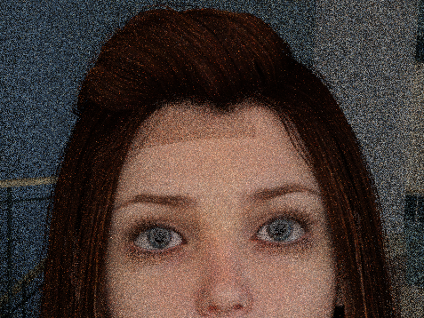

    I have similar issues with another hair (Aubree). Works perfect in 3Delight, but when I render it in Iray, there's a strange shadow on the scalp-line:

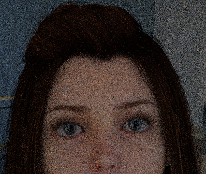

    Actually, it's more like a reflection. I have a light exactly on that side. If I turn that light off, and only let the skydome light the scene, the shawod (reflection) is gone:
    If I move the light over to the right (her left), then there is no reflection, and it looks like it should:
    So for me, moving the lights around seems to solve this issue. At least for this hair.

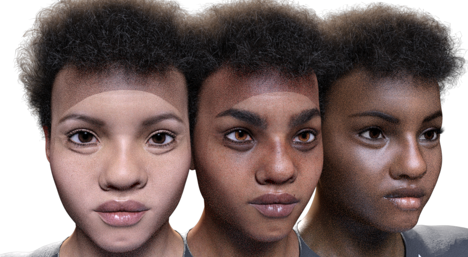

    Previously I could resolve this problem by deleting and re-adding the character, lights, or hair.
    None of that works now. I've renamed the scene, checked the gamma value, and all the other suggestions above. The problem is happening with some, but not all, characters and hairs. In the attached image it affects two of the three characters; all three are using Iray surfaces.
    Adding more light reduces the problem but doesn't eliminate it -- and not every scene can be brightly lit.
    Does anyone have other ideas about how to fix this?
