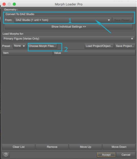

  • Cris PalominoCris Palomino Posts: 13,034
    What program are you using to make your morphs?
    When you export, you will set what scale you export at; it is important that both export and import utilize the same scale (see the image from Tottalou).
    It is important that if you work with the base geometry (which is critical) that you do not subdivide or use and tools that add or remove geometry as this will change the vertex order.  As Richard mentioned, the Mouth Realism and Navel morphs should be disabled (set to zero).  If you're working in ZBrush, you can use most of the brushes.  Brushes such as curve brushes will add additional geometry as will working with ZModeler.  The numbers you show "Base does not equal target(16828!=67312)" indicate you subdivided.
    Take note of the number of polygons in your base.  It should be 17K for the female; 16,828 for the male.  Occasionally check that the number has not changed.
    MLP, Morph Loader Pro, needs you to set the same scale as what you used for export.  This is what Richard meant.
    If you are working with the base Genesis 3 figure, you will not need to use Reverse Deformation (you will if you begin to make morphs for characters such as Victoria 7 or Michael 7, which are morphs of the base).
    Where you place the morph depends on the type of morph it is.  You can easily leave it with the default which will place it as a morph in a Morph Loader Pro category in the Parameters tab (this is the easiest place to find it).  You can change the location later with parameter settings.  For testing, the MLP category will suffice.

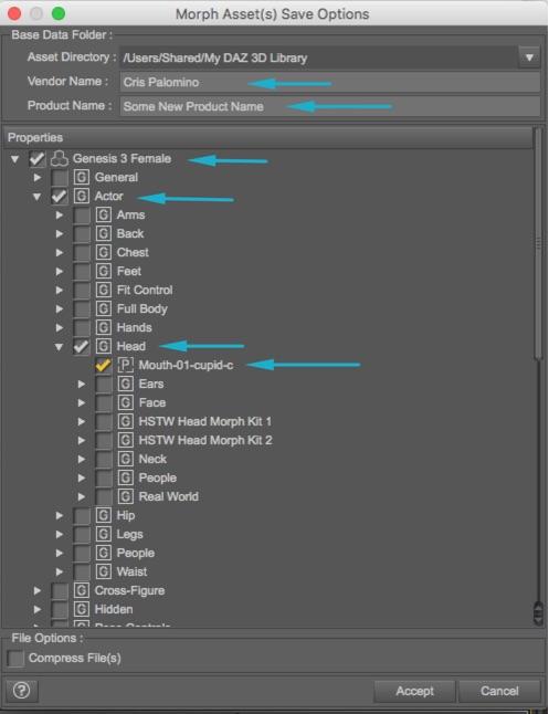

    edited July 2016
    Ok, see this is a good example of why it is important to lay out your exact process.  You are using a head morph resource kit.  Hopefully you read the licensing agreement for the use of these morphs ( http://docs.daz3d.com/doku.php/public/read_me/index/31276/start).  Some kits require you to make morphs that must, in turn, require the customer to have those morphs in order to utilize yours.  It would be a different process for setting that kind up for distribution.
    artoir said:
    Ok, sorry if I haven't been spacific on what I'm actually doing. I am using Genesis 3 Male Head Morph Resource Kit 2 within Daz Studio.  Following Richards steps to the best of my ability on the thrird post above.
    artoir said:
    I load genesis 3 and zero any morphs left on him out and leave him in the default pose.
    This is fine.
    artoir said:
    I apply the head merchant resource morphes, shaping them to my liking. No poses, no other morphs and set the mesh resolution to Base.
    Fine, too.
    artoir said:
    Now this is where I feel like I'm messing up.
    artoir said:
    I export it in Wavefront.obj (that's the only choice I get as an obj.) As in the screenshot below, I leave the default settings alone. Including the "Convert To Daz Sudio to: Daz Studio (1unit = 1cm)  at the top. (I'm actually doing this as I type)
    This is correct.
    artoir said:
    Then I go to Morph Loader Pro, but Wavefront (obj) isn't in the list to convert it to Daz Studio From: dropdown,
    This is where we have been trying to tell you that what MLP is looking for is the scale that you want to import at and that this MUST be the same as the scale you exported so you choose Daz Studio.
    artoir said:
    so I choose "Custom".
    Do the above, previous, instead.
    artoir said:
    I chose the obj file in "Choose Morph Files",
    Correct.
    artoir said:
    Drop down the file list and right click on Property Group and choose Actor/people. Hit Accept and get "Morph Created Successfully"
    I would use Actor/Head.  This is a head morph.  Actor/People is usually for full character morphs such as Victoria 7 or Michael 7.

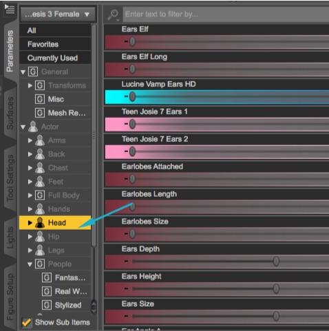

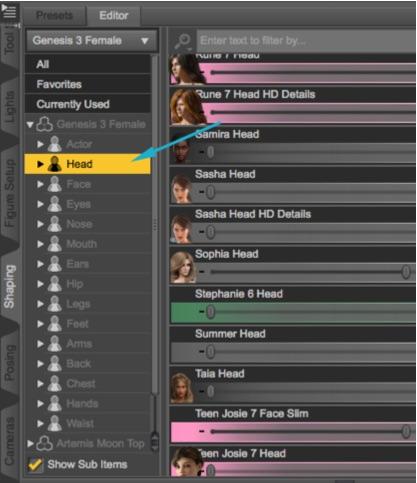

    artoir said:
    Now where did it go? I can't find it in my Daz files anywhere.
    Select the Genesis 3 Male root.  Actor/Head should be in Parameters under Head or Shaping under Head (if you use what I suggest).
    artoir said:
    When I try to save it as a morph asset I get vendor name and Product name. But the only two choices I get to save it in is either C:/Users/Me/Documents/DAZ 3D/Studio/My Library or C:/Users/Public/Documents/My DAZ 3D Library, as well as the choices as what to save in a tick list below, from Genesis 3 male at the top (on to pelvis, left thigh bend etc.) to Head at the bottom.
     I believe you need to use the one that ends in My DAZ 3D Library to be correct, but I just got contradictory info (as I am on a Mac, not a PC).  I have to check with Richard to make sure, so wait on this one.
    artoir said:
    The Genesis 3 male at the top has a dropdown containing Actor, Hidden, Morphes and Pose controls. Sorry I'm being such a pain, I wish this would all soak in, if I don't get it this time, I give up.
    You need to know where your morph is in order to properly save it and you will drill down to it in the asset window with the same path you used to create it.
    Hopefully, that explains it.  I'll get back to you on the library location.

  • Richard HaseltineRichard Haseltine Posts: 111,852
    The folder you pick in the options dialogue is the base folder - in that - for this - you will go to \Data\DAZ 3D\Genesis 3\Male\Morphs\Author\Product (where Author and Product are the names from the options dialogue) to find your morph files. Morphs always go in the Morphs sub-folder of the basic asset folder for the item being morphs, that way DS can find them and load them automatically.
