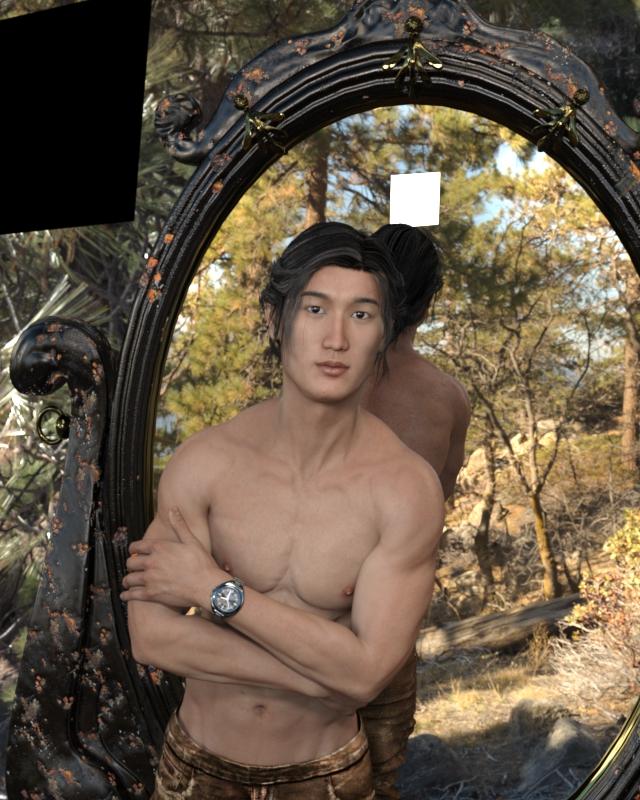

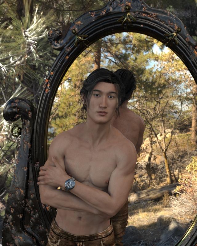

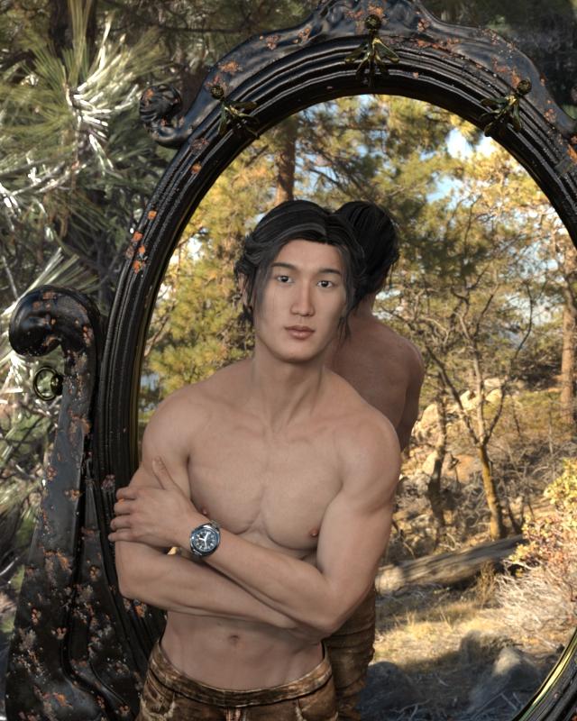

    It works! I tested it. My character is still lit when I set the emissive plane cutout opacity to 0.0001. I lose the reflection of the white emitting surface in the mirror and also on other reflective surfaces in the scene. Somehow I was expecting it to disappear from the mirror, but I hadn't thought about losing reflections from metal, glass, etc.
    Emissive Plane Cutout Opacity 1 (normal):
    Emissive Plane Cutout Opacity 0.0001:
    Emissive Plane made invisible with the "eye" in Scene Pane (no light emitted):
