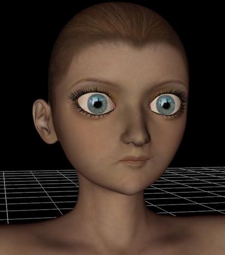

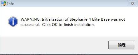

Today I bought S4 starter pack. After installing. The installer prompt me to initailize S4. I clicked ok. But the installer said it failed to intialize. And When I load S4 it is looks weird. What should I do? I tried reinstal for several times, but it does not work. I am using ds 4.5

    And all my other figure can not load well now. They all changed shape. What should I do? Help
    549 x 623 - 46K
    S4 is a morph of V4, and MUST be installed into the same runtime folder as V4 is installed to.
    Are you doing that? What is the exact error message when the initialize step fails?

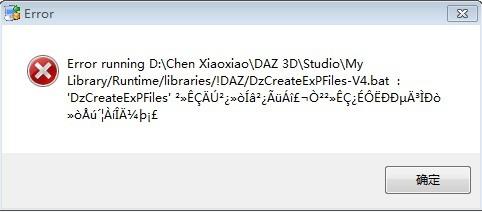

    This is the error message

    There is a file in Documents > DAZ 3D > Studio > My Library > Runtime > libraries > !DAZ, called DzCreateExPFiles-V4.bat. You should try to run that.
    When you install S4, another .BAT file should be created for S4 as well. Try to run that.
    All the BAT file does is call a file named DzCreateExPFiles.exe which should also be in that same folder.

    The error you were getting during the install of S4 was for DzCreateExPFiles-V4.bat
    Have you tried running it from that folder to see what happens?

    What file is the initialise trying to run (look at the error message) It is probably the V4 bat file again.
    You should maybe reinstall the V4 Base figure to see if that gets rid of your problem.
