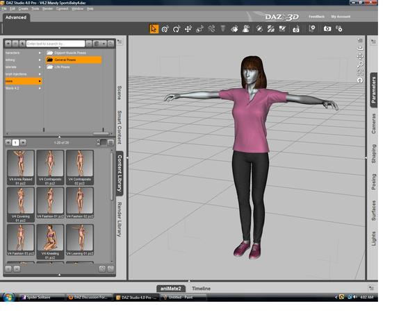

Hi, The shirt sleeves on my characters clothes don't move with the character. I believe I need to connect the bones of the shirt with the arm bones of the character. Is there anything I can do about this; and read about how to correct this?

I should have said this is in Animate using aniblocks. In DS4, The character is a modified V4.2. As a still image the shirt(Hondyu's Sports Baby 4) fit fine until I use a pose. See Attachs.
It is not moving with the figure either because it is not 'Fit To' the figure as previously explained, or it is NOT a piece of Conforming Clothing.

You still haven't said if you are using the 'Fit To' option? You MUST use that for conforming clothing.
The example I am using is with Genesis, but it works exactly the same with V4. If that doesn't work, then there is something wrong with the clothing, and you should write to the vendor at Rendo I think.
The character is V4.2 not Genesis V4. It one of my Daz 3x characters. OOOps, I just went into Misc. and found that it was fit to the pants. I get up pretty early to have some peace and quit but sometimes I'm half asleep. Thanks for the Help, Mark
