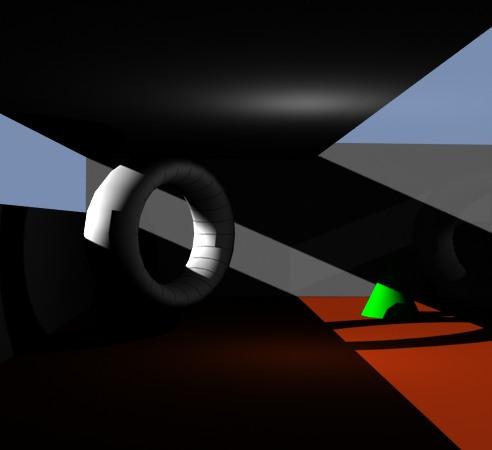

Test images. Boxes, torus, and cone with a glass plane to the right of the torus. One photon mapped distant light and one photon mapped point light.
DazGI_6 - Indirect light camera. Glass 0% opacity. Glass and reflection invisible. Direct light goes through to outside but does not bounce back in through glass. Ceiling lit outside glass by bounced light but stops there not lighting inside ceiling.

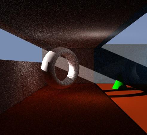

DazGI_7 - Indirect light camera. Glass 0.5% opacity. Slight reflection visible. Ceiling looks dark beyond glass.
DazGI_8 - Normal render. Glass has slight reflection visible.

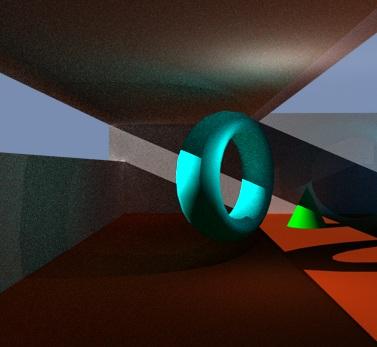

    Here is an image showing reflections in the glass (8500% reflection stregnth, 0.3% opacity) and color bleeding. That image rendered in 26 minutes on a 2.6 GHz dual core.
    The camera attribute Samples controls the quality of the image. The reflection image had 100 camera samples and 100,000 photons the lights and the camera. I'm not sure why the camera has a Number of Photons attribute.

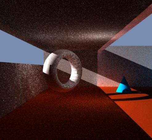

    The next image tests shadows from indirect light and that indirect light penetrates the glass. A photon mapped spotlight bounces off a wall and ceiling in a room to the left, through a glass plane over the opening, and illuminates the room and makes shadows. This took 10 minutes with ray depth = 4.
    My photon mapped lights don't have the controls that appear in the work area to change the brightness and the width/angle for the spot light. There are sliders for them.
