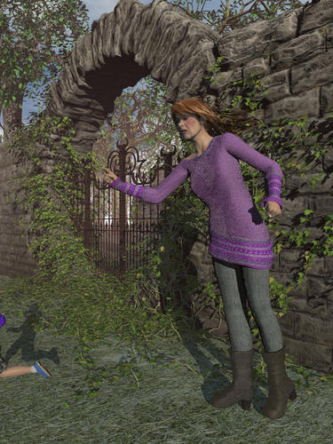

    David knows I mostly do use gamma correction, because I like to do soft, watercolour type landscapes.
    This one I have rendered two ways. One with and one without. (also other corrections in the second)
    "But Muuuuuum, you did say it was a moon gate"
    675 x 900 - 383K
    675 x 900 - 404K

    David questioned me about using it with the pull toy I created and I did a render with it off. In that instance it had the reverse affect of washing out the colors, so I left it in. It will be something I'll give more consideration to in my next works.
    Going by Chohole's examples, as Horo said it's what the artist decides. However, to me the left scene look better because everything doesn't have that Hollywood spot lighting affect. Perhaps the color intensities are a bit to high, but that scene leans more toward the real look of things. Or how I perceive things should look.

    About your images...
    I like more on the first one:
    - the vegetation (colours, light response)
    - the mom's clothes (colour and light)
    - the mom's left hand (fist) and angled right hand's finger (on the second picture she looks more like she was laughing out from the kid)
    - light under the gate's arch and less intense shading of the bump.
    - shadows of the left hand - because of making the shadows lighter on the second image they're almost non existing under the palm
    and on the second one:
    - mom's face colour and ground colours (they look more like the creator of textures intended them to)
    - fog on the background (it's not going to almost fully white)
    - softened shadows

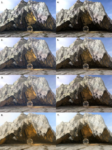

    Here's my example with using gamma without washing out the texture colours. She scene consists of:
    - infinite plane
    - 3 terrains forming the cave (slightly modified stalactite pro material)
    - glass sphere (refraction only)
    - sky turned into hdr for finer control with opacity of 75% blended with flat sky colour, atmosphere is turned off
    - sunlight (very pale peach-orange, 100% intensity of shadows)
    - mid cold blue ambient making the stone material glow with 20% strength (only for scenes 1, 2 and 3)
    - orange point light with inverse square response
    It's rendered wit relativity low TA samples (9) and number of bounces (3)
    1. A scene with gamma correction off, ambient appears slightly like a fog giving some light to dark areas. Ambient in TA mode does not appear that flat - it rather looks for me like some kind of inverse ambient occlusion. Notice burned out directly lit areas as well as hdr background.
    2. The same scene as 1, gamma correction option is on, I used the formula that I've written above for fixing colours to appear the same with gamma used. All colours swatches were fixed - including the ones for lights, ambient, and those inside the procedural texture, no light intensities were changed. You can see softer distribution of lights (no burning out to white at the parts of the cave exposed to direct light).
    3. The example pushed further than the Bryce allows in default workflow. The colours were corrected from 1st example - now by inverse of 2.2 gamma, and so was the final render. Now you can see that ambient materials are really glowing, and that ambient light is bouncing around and polluting the whole scene.
    Side note: I rendered the image with gamma correction option turned on + some more, remaining gamma was added in the raster image editor (I could also render with gamma correction off, save as *.hdr and apply gamma in the editor that opens *.hdr images). The process of degammaing your inputs and applying 2.2 gamma on your final image is called sometimes linear workflow. Options to make it easier to follow and more automatic are often incorporated in modern graphic applications.
    4. The scene from the 1st example. I removed ambient colour from the sky settings and from the materials and made the sunlight stronger (135 from 100), HDRI effect from 20 to 25, and intensity of orange light inside lowered from 50 to 25 (as it appeared too strong for me for such lighting conditions outside). Despite the TA turned on, and such strong light outside you can't see almost anything in dark areas of cave.
    5. The scene from 4th example with tweaks as described in 2nd example. This is looking quite realistic already, I really like that setup.
    6. The scene from 4th example with tweaks as described in 3nd example. Not that strong difference from 5th example, a bit more light in the shadows and it's more physically correct.
    7. I decided to push 6 further. With some colour corrections and slight noise removal I made the version that I really like. It's more comparable with its dynamic range with 5th example but the light areas of the stone became silky-smooth and the shadows are more saturated now.
    8. Bonus scene - the 5th scene with the sphere with basic volumetric material around the whole cave. It was too pale so I restored the shadows strength and saturation to the levels I wanted.
    900 x 1200 - 2M

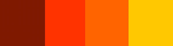

    In turn my thoughts have turned to colour. There is, I believe, a related problem. For example, a colour red 1,0,0 has 255 discreet stages of intensity that it can go through before it hits the limit 255,0,0. This colour 127,1,0 only has two discreet stages of intensity, the first one and 254,2,0 there are no other intensities which represent this precise colour. A doubling of lighting intensity will result in red being capped 255,4,0 - this distribution of RGB does not relate to the original colour and with more light thrown in, the situation only gets worse.
    First example shows the progression with sunlight intensities, 100,200,400,800
    127,1,0
    254,2,0
    255,4,0
    255,8,0
    In this case though, after the initial doubling of light, the colour seems to settle down... so it does not seem all that drastic...
    Now consider the situation with 127,25,0...
    127,25,0
    254,50,0
    255,150,0
    255,200,0
    Then the scaling of green begins to rapidly catch up with red, so that what appears to be red under low light rapidly morphs into yellow under more intense lighting conditions.
    With only two more doublings, what was ostensibly red will become definitely yellow.
    It is all very well being able to provide a good range of light, but the colour response needs to have a corresponding range to cope with this flood of light.
    What can be done to overcome this problem?

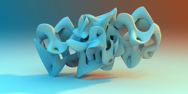

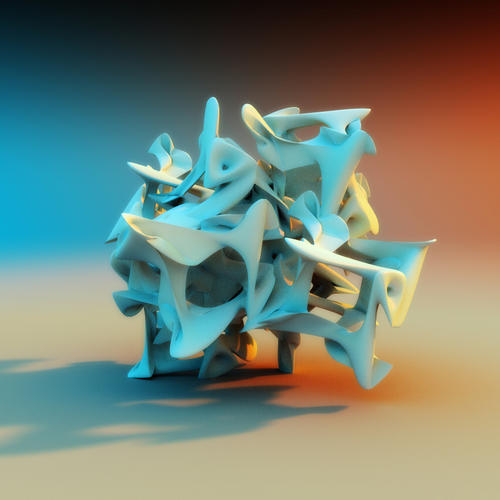

  • David BrinnenDavid Brinnen Posts: 3,136
    Bryce 25 minute scene project - wings3D to render to postworks - a video by David Brinnen
    Where I discover things about colour depth to my disadvantage...
    1700 x 850 - 476K
    850 x 850 - 243K
