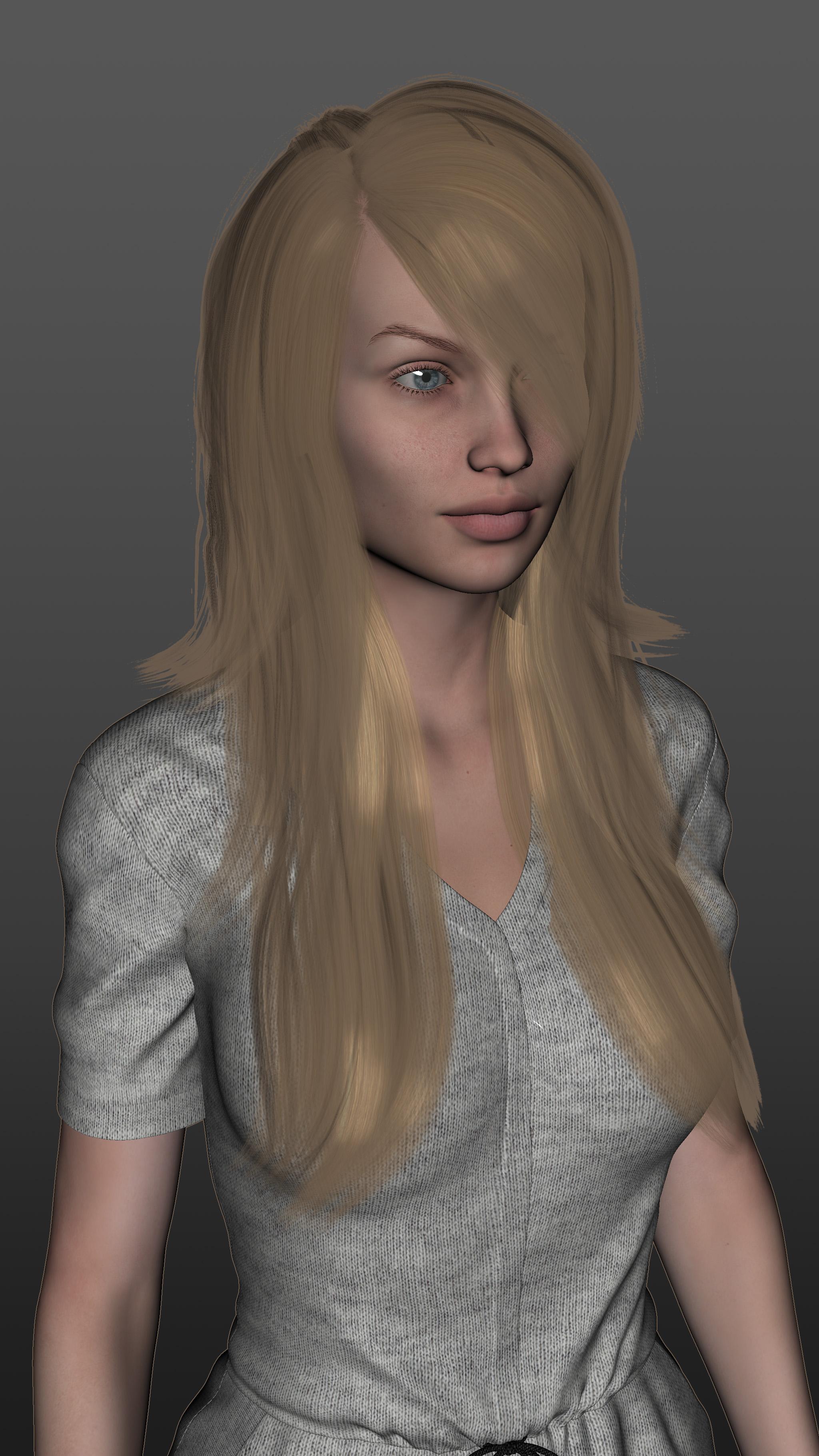

Actualy we all could use more bones in the hair to change the styling.
Seriously some of the hair is by default a bit oversized for my taste. Or maybe the bangs cover to much of the face. Recently I foud myself more often trying to reshape and style some hair with a bunch of defomers and more important adding a smoothing modifier to let the hair collide with the figure.
Here is what I did lately with my new GDN Claudia for Eva 7. The hair does have a bunch of helper bones to change the appearance allot. Also the hair comes with some styling options that manages the helper bones to do the behind sholders style. These are also usefull to let the hair move a bit in diffrent poses I think.
1. Original hair fitted to figure / 2. my hair style / 3. my setup screen:
