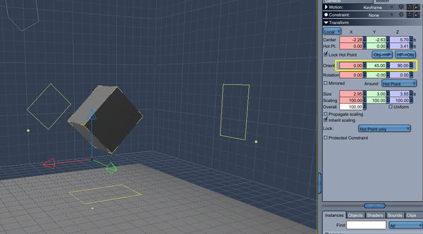

    in the screen capture below, you can see that the object orientation has been changed, and the objects hot-point is now outside of the object,. but the object rotation is still at zero.
    Hope it helps :)
    982 x 544 - 111K

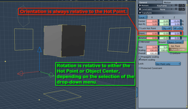

  • de3ande3an Posts: 915
    3DAGE said:
    The Orientation is independent of the objects Hot-point.
    The Rotation uses the objects hot-point as the centre. irrespective of the objects orientation to the hot-point.
    I'm observing a different behavior.
    I find that the Orientation parameter always moves an object relative to the object's Hot Point position, and the Rotation parameter can move the object relative to either the Hot Point or the Object's Center, depending on the selection made in the drop-down menu.
    This is for the Mac version of Carrara 8.5.
    908 x 528 - 56K

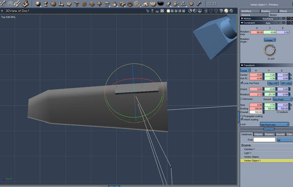

  • 3DAGE3DAGE Posts: 3,315
    Hi Titanic401 :)
    Apologies for my tardy reply, ...I had to sleep :)
    I remember Richard asking this same question a couple of months ago, but I couldn't recall the answer last night.
    When you add the Axis Constraint to the wing flaps,. you can set the values for X, Y , and Z (this will visibly change the alignment of the objects hot-point (see pic).
    You can also set the limits of rotation for the main axis.
    Hope it helps.
    Hi de3an :)
    I'm thinking that a target helper,. in the centre of the ship,.. would possibly work to adjust all the flaps ,... just guessing
    Fenrics ERC is also a good option.
    I suppose the way the flaps work depends on whether it's a flying saucer, or a more conventional (fixed wing) WW2 aircraft,
    but in either case, setting the constraint allows you to angle or alter the alignment of the hot point.
    Headwax and McGuiver are also right , you could do it with Bones or Morphs, ...both methods will work, and are equally valid.
    but the hot-point alignment, and the angle of rotation limits can be adjusted when you apply the constraints.
    1224 x 783 - 142K

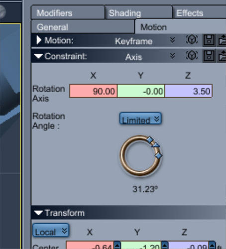

    HI,.. I forgot to upload this earlier,. it's a Zoom in of the screen-capture above.
    you can set any axis by adjusting the others,. so in this case where the wing model is level to the floor, I need the X value to be 90 degrees so the constraint "gizmo" flips up to the vertical.
    I've then limited the amount that the "Flap" model can rotate.
    hope that makes sense..
    489 x 538 - 41K

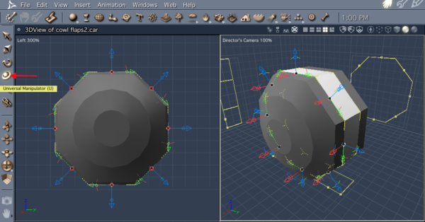

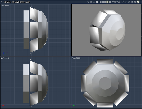

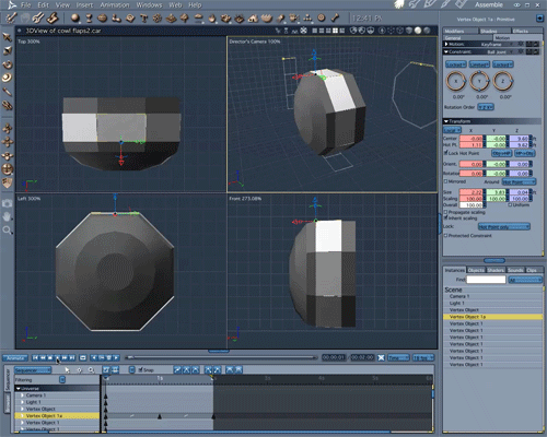

    I think I got it. A real puzzler.
    First, arrange the flaps around the cowl such that the xyz axes are oriented uniformly so that a rotation in one axis will move the flap in the correct direction. Move the Hot Points for all of the flaps to the leading edge of the flaps. This can be done all at once by selecting all of the flaps at the same time and while the Caps Lock key is active, move the Hot Points.
    Use the Universal Manipulator to view the axes relative to the flap, rather than relative to the workspace. (See image)
    Select each flap and apply a "Ball Joint" Constraint. In the case of this model the rotation of each flap occurs around the y axis, so the constraints for each axis was x-Locked, y-Limited, z-Locked. The "Rotation Order" needs to be changed to YZX before it will work correctly.
    (FULL DISCLOSURE: I have little knowledge about what "Rotation Order" does. I found out by trial and error that I needed this setting to make all of the flaps rotate the correct amount in the correct direction.)
    Select one flap (I used the top one) and give it a unique name, such as "control flap".
    Select each of the other flaps in turn and apply a "Track" Modifier. In the modifier properties check "Track Rotation" and uncheck X, Y, and Z. In the "Towards" parameter choose the flap that you renamed "control flap".
    After the "Track" Modifier has been applied to all of the flaps, rotating the "control flap" around the Y axis should cause all of the other flaps to follow suit.
    EDIT: For some reason my animated GIF isn't displaying properly when posted here, but you can still kind of see what's happening. I'll fix it if I can.
    EDIT2: If you click on the animation it will open in another window where it will display properly.
    500 x 400 - 2M
    1025 x 536 - 176K
    Post edited by de3an on
