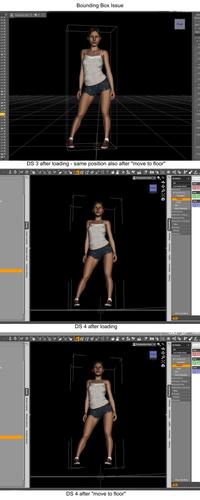

    and now here are the screenshots. take your attention on the bounding boxes
    the bounding box in ds 4 is much larger than the figure

    Did you scale her height?
    It doesn't look like she fills the bounding box in either one, but in DS3 the extra space looks to be at the top of the bounding box. In DS4 it looks like she's now floating in the middle, with space split between the top and bottom.
    If that's the case, try saving her without the height scaling...then after she is in DS4 apply the scaling and save a DS4 version.
    means I should scale her in ds3 back to the original 100% and save it in ds3 then load her in ds4 save her and load her again, scale her back to 97% and save her again in ds4 and then everything should be okay, am I right?
    That's what I would do...along with make sure her feet are at the bottom of the bounding box, after returning her to default size. Also, make sure that there is no pose applied to her for import. You can apply the pose after importing, before saving in DS4.

    have zeroed the scaling parameters, also leg length and pose and... the character is correct in the boundingbox but it
    doesn`t work, if move to floor the boundingbox itself is not set to the ground.
  • cosmo71cosmo71 Posts: 3,609
    the thing is that in ds3 the bounding box fits to the scaling of the figure, in ds4.5 this is obviously not the case

    As my main V4 characters are all shrter than the default, I can verify that ALL versions of DS4/4.5 have done exactly the same thing. This is the way it looks to me...
    DS3 works by moving the bottom of the figure to the floor (Y = 0) location.
    DS4 works by moving the origin to the right location so that a default V4 would have her feet on the floor.
    that is probably the reason. sounds comprehensible. well, I can live with it. have to fix the pose anyway in a scene so doesn`t really matter. I save my self created poses most of the time as pose preset so.
