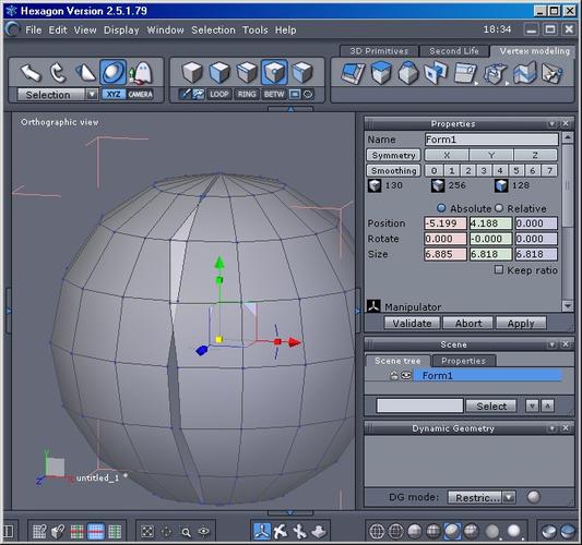

I made a sphere, cut it in half, and then mirrored it. Then I deliberately snaggled various points to exaggeratedly mimic problems commonly encountered while modeling half sections.

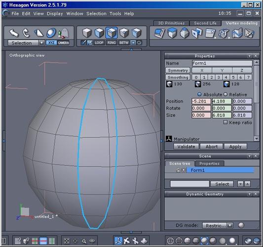

Then I selected the edges as per Ghostman's method. Note the yellow arrow pointing at the "X size" parameter. This non-zero value indicates a deviation of some edge positions from a common vertical axis.
Set that value to zero and hit enter, and you get all the edges snapping perfectly aligned and vertical. (some details here that are usually no major problem but that you MIGHT want to check on with some models are that this method only assures vertical axis alignment. It does NOT assure that this vertical alignment is perfectly centered between the 2 halves (although it usually is), and it does NOT assure that point pairs are matched HORIZONTALLY)
From here you can convert edges to points and then average weld them.
