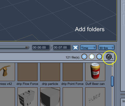

    You can add the presets folders manually to the beta, ....or you can install the Carrara Native Content into the beta program folder.
    Personally, I don't bother adding the content.
    it's easier to add any existing folders to the browser,. rather than duplicating files I already have.
    Hope it helps :)
