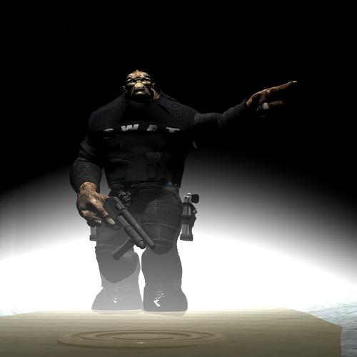

  • CreekyPointStudiosCreekyPointStudios Posts: 30
    edited October 2012

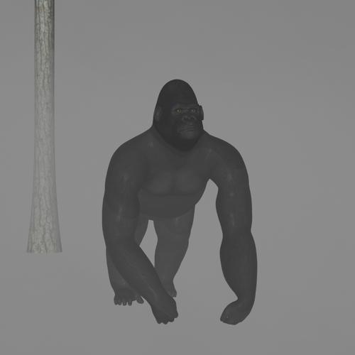

    Ok - it seems to work in DS4.5 just fine - there are many options to adjust the planes & the levels of fog (so many options) - this is a very quick & not very good render that I threw together to show the tool in DS4.5 :) With adjustments you could probably get the look you are after :) hope that helps :)
    *The Gorilla is between several vertical planes - that is why the effect looks a little odd - with adjustments that cut through effect could be reduced, but I wanted to get an answer to you fast :)
    BellaDragon :)

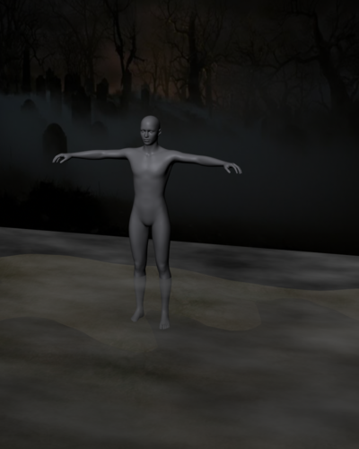

  • DWGDWG Posts: 770
    edited October 2012
    Another example with the Fog Tool, I recently checked this out in 4.5 and it needed the settings tweaked in the surfaces tab, but nothing particularly complex:
    1500 x 1500 - 140K
    Post edited by DWG on
  • RKane_1RKane_1 Posts: 3,039
    Forgot pic, DWG?
  • DWGDWG Posts: 770
    No, picked the thumbnail by mistake - fixed now!

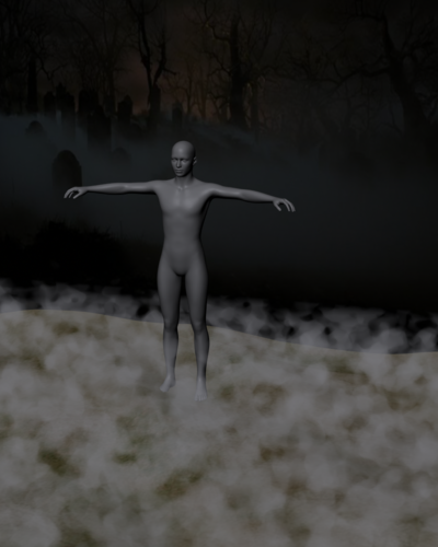

  • smoke14smoke14 Posts: 271
    Here is a real quick and dirty render using it. I used three of the six different planes and just moved them around. Not sure if this is the effect you are looking for, but it might work.
    1650 x 1320 - 927K
    If you use multiple instances of the plane it should look thicker. Glad I could help.

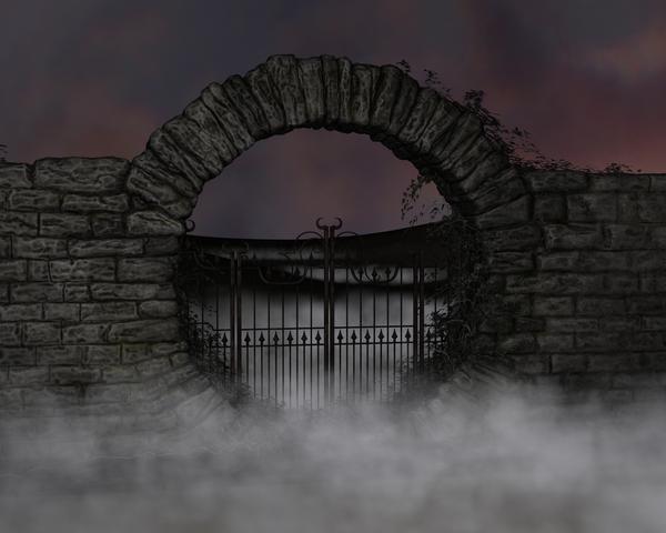

    Here's a quick update with more planes added to make the fog look thicker. Also added some between the hills.
    1650 x 1320 - 908K

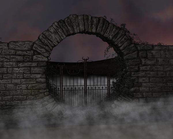

    Here are a couple of more options...
    The first is a shot of what UberVolume is capable of...
    It's a simple cube with UV-cloud applied. The cube was scaled along the Y-axis to knee height, otherwise it isn't 'ground' fog...
    The second is my attempt at building a simple fog shader in ShaderMixer...
    800 x 1000 - 699K
    800 x 1000 - 759K
