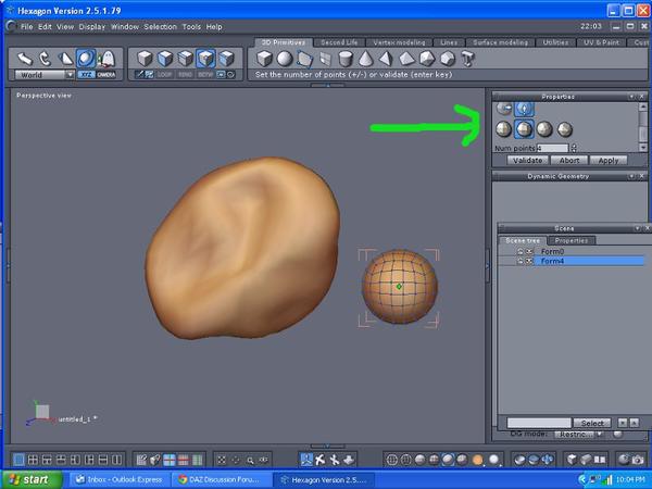

    Something like this?
    Insert sphere, select one of the geodesic options, bring the number of points down quite low - in this case I made it four. Validate.
    Select faces or verts, with soft selection active and push/pull until you get the shape you want. For jagged, don't smooth. for smooth, select level 1 and once you are happy with the shape, collapse DG by hitting the lightning bolt.
    If you intend making the entire wall from individual rocks, you are going to end up with a seriously high poly count - better to model the the general shape of the wall and use a texture with bump or normal mapping to get the detail.
