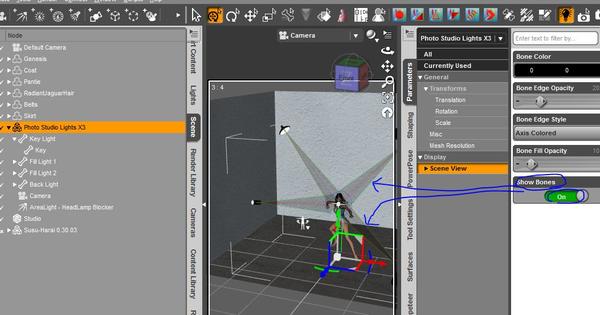

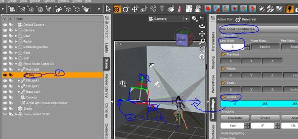

    und,, I think when you adjust each studio light direction,,,, "local cordinate" is useful,,
    because when select each light (not shell) 3d manipulator (Z blue axis) by 3d universal tool,
    it make guide line where each light are turned to.
    and usually I change stuido bone visiblity "on" it make you clear where these light face to.
    I hope it may some help you (I like much IE light sets,,^^;)
