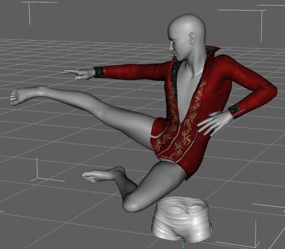

Hi,
I have created a Genesis character, and added a jacket, shorts and shoes.
When I go to pose the character, the character, jacket and shoes all pose together. The shorts, however, do not.
I have tried a number of shorts on the character, and they all misbehave in the same way.
How can I fix this ?
thanks,
Andrew
    Do you have a screen shot showing how they are misbehaving?
  • fixmypcmikefixmypcmike Posts: 19,726
    If you right-click on the shorts and choose "Fit to", does it show them fitted to Genesis or to None?
  • mathmanmathman Posts: 0
    Screenshot
    571 x 499 - 61K
    Both Jacket and Shorts fit to Genesis. They are part of the same set (Magus).

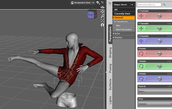

    Here it is
    1035 x 659 - 144K
    1035 x 659 - 144K

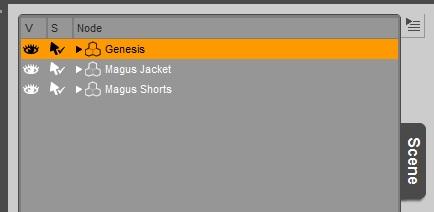

  • Canary3dCanary3d Posts: 2,033
    1. what version of DS are you using?
    2. can you show a screen capture of the "scene" tab?
    3. are you loading this from the "smart content" tab or by browsing the content library?
    1. 4.5.0.114 DAZ Studio Pro 64-bit
    2. See pic.
    3. Browsing the content library.
    434 x 212 - 15K
    There is something wrong with your install of these items. As has been pointed out, the shorts should load with a texture, yours are grey, amd they should also be conformed to Genesis.
    Do you get any error messges of any kind when loading the Magus Shorts? Have you looked in the Log File, Help > Troubleshooting > View Log File to see if there is any clue in there when the shorts are being loaded? What is the file extension of the Magus Shorts in the Content Library tab? is it Shorts.DUF, or something else?
    I take it that you did install the Genesis Starter Essentials file, that is the installer that contains the content now, as it does not come with the main installer like it used to?
    I think you should re-install the Genesis Starter Essentials, as it looks like something has got corrupted, or did not install properly. The installer should only re-install the files that it installed in the first place.
