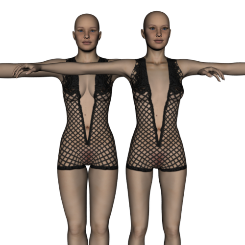

    I find that some of the body morphs are not transferring when I use GenX. Notice the thickness of the arms and legs and the size of the breasts.
    600 x 600 - 269K
  • fixmypcmikefixmypcmike Posts: 19,731
    Did you inject the morphs++ (or whatever morphs are required)?
