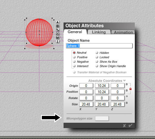

  • David BrinnenDavid Brinnen Posts: 3,136
    True... but... OK, I reckon it was the other mesh it refers to, the micropolygon mesh not the wireframe mesh that displacement relates to. This is adjusted here, but displacement has to be set in the material first before a value appears. Then you have to get to the attributes and set the mesh size down before Bryce notices and crashes. Then - just then - you might get it to work.

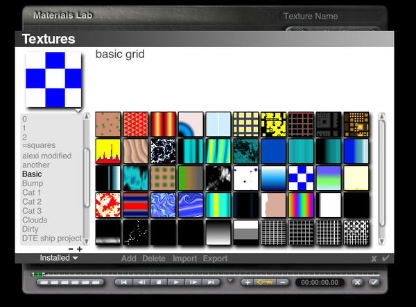

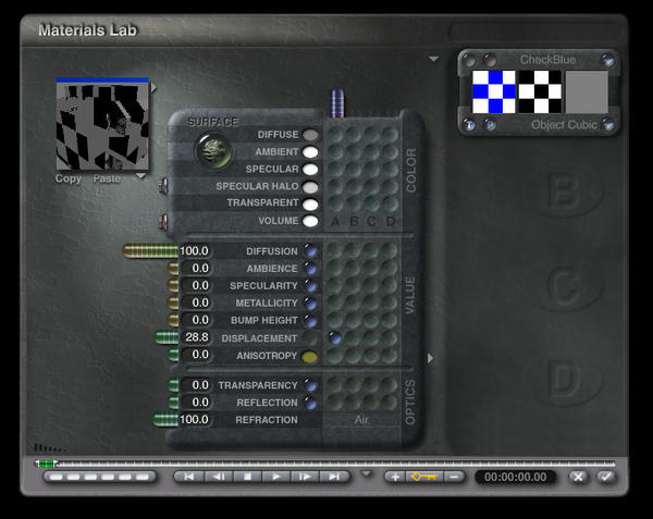

    Steps which worked on my system
    Windows 7 Pro
    64 bit OS
    Intel i7 CPU
    6 Gb memory
    HD 5850 GPU
    1 from launch. Create a Bryce primitive cube
    2 set displacement value (see 1st image)
    3 put a blob in Channel A (again 1st image)
    4 exchange the texture component in A for basic grid (2nd image)
    5 render (3rd image)
    Note that in while the geometry is self occluding, self shadowing of the new geometry is not working correctly. Also the mapping modes are not adhered to according to.
    The source files saved without crashing, it 78kb in size and if you want to have a copy of it for testing, send me an email and I will post it back to you.
    Note that any successfully saved source files with displacement materials within them, in order to get the displacement working again it is necessary to enter and leave the material lab for each displacement material to restore the link with the texture channel output (in a similar way as is necessary for extracting (colour) normal information from the bump channel). Bug tracker fans https://bugs.daz3d.com/view.php?id=39540 if you can get in this deep.
