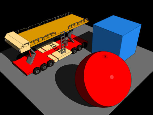

    It is supposed to make it "flat" looking. I'm using the C8 version on Windows and if just put it on a sphere and render it the sphere will just look like a colored cell circle.
    If I want it to show in the render that it a sphere done in a "cell style" I need to light the scene differently. :Iight settings and placement will affect how "flat" it looks.

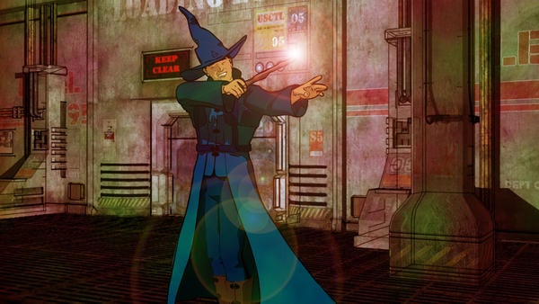

    Toon Pro Render
    YAToon Render
    AE filter and blend
    Rotoscope final character artwork
    It's either that or FlyingDutchman's
    Traditional Render
    Toon Render
    Blend Render
    Anime Studio Render
    Final Blend Render
    I made the decision to abandon Carrara Toon style animation and instead just apply what I've learned to still images, which I'm transforming into a motion comic in AE. To me, either motion comic or separating the pieces of an image into individual symbols for Flash style animation are the only two viable options. Anything animated solely in Carrara or DAZ in the "toon" style is probably going to leave you less than thrilled -- which isn't okay considering the amount of work that's required to animate.
    But like I said, toon shaders with some post tweaking is completely solid. This image is largely Toon Pro just doing it's thang.
